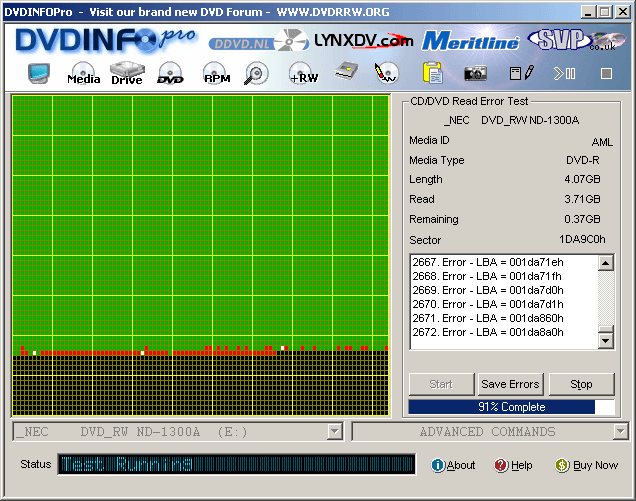

  7. I got a 100 Pack of the GRADE A SUPERMEDIA 4X INKJET PRINTABLES.
    I tried three of them on two different burners (NEC and PLEXTOR).
    I don't have time to finish the scan but here it is at 91%
    And please spare the... only buy Taiyo Yuden or Made in Japan or Prodisc comments... I got these by mistake.
