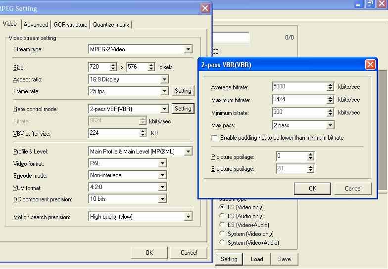

when i do a 2 pass vbr, the first pass goes fine then at 50% when the second pass starts it messes up and an error turns up. this has'nt happened on every single ocasion though and i have checked files for errors and they seem fine. i dont know what im doing wrong

i think it only happens when im am doing an xvid but ive done xvid's before anyway these are the settings im using
there's nothing in your settings that suggest there's a problem.
