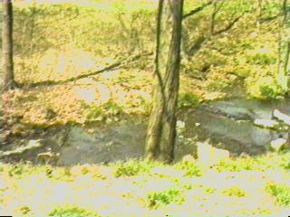

  1. I have a Pc Chips PCI Capture Card... and I am trying to convert my old 8mm movies. However, the light areas in my captures from my camera are way too light... it seems like bleeding, since even darkening it or changing the contrast doesnt help much. I tried hooking my camcorder up to my VCR... it looked terrible. My camcorder is like 20 years old... is this macrovision?
    Look at this example:

  5. I get a similar problem with my ATI AIW Radeon setup. Basically, your input levels are too hot. From my experience, capture cards clip the video levels at 100 IRE, so anything above that will get clipped, and detail will be lost.
    You need to lower the brightness levels going into the capture card. If you have a brightness control somewhere on your software, then you should be able to lower the levels so that they don't capture too hot. Once it's captured though, the detail is gone, so lowering your levels won't help.

  8. Yea, thanks for your help guys, but this is Very frustrating. I've tried changing brightness, contrast, sharpness, on preview and onthe card, nothing has looked right. I have tried recording to a VHS then recording to the card via VCR, but that didn't work either. It just doesnt make any sense. I hooked up my Xbox to the A/V input in the card, no bleeding. It just doesn't want me to get this working. I have even tried RF in, and get lower quality AND still bleeding. Its like an incompatibility with anything the old camera has ever recorded. I even burned it to a DVD, and played it on my TV, same thing as it looks like on my monitor. I am almost ready to give up. There is nothing else I can think of to do.

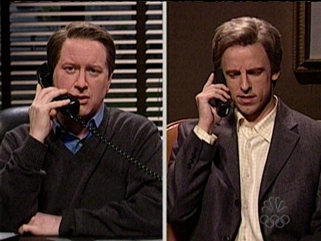

  23. The SIMA looks cheap enough that I amy buy it... But this is soo weird. Look how good last nights episode of SNL looks:

    It doesn't look like your capture card has any problems with capturing if the source is good.
