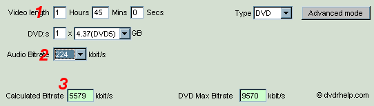

Use DVDRHelp Bitrate Calculator.
Enter the playing time of the movie at 1
Select the audio bit rate you use at 2
Read the available video bit rate at 3
Enter this value in TMPGEnc
/Mats -
