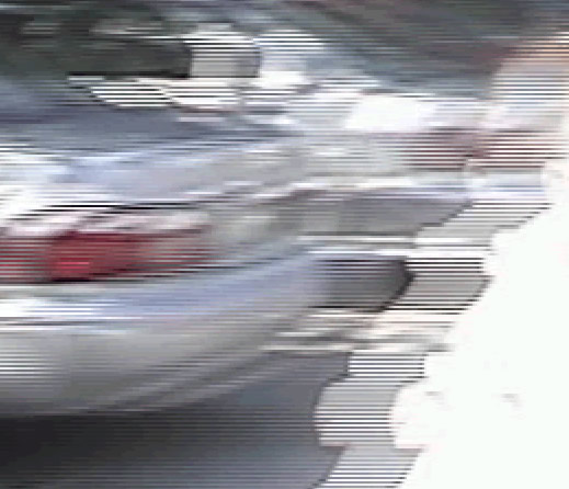

    I've downloaded and tried several of the reccommended capture utilities and various codecs but all of my video has visible lines whenever the camera moves/pans.

  2. Here is the screenshot. I paused it while the camera was panning and blew it up 3X to give a better view of what it's doing.

    Horizontal lines? If so thats interlacing and is perfectly normal. You won't see these lines when it is displayed on a TV set.

    Are you capturing to DV AVI ? That is raw native Digital Video AVI for later processing ? If so, it should be quite watchable and not so pronounced. I watch AVI's all the time and yes, you can tell they are interlaced and will look find on TV but his is quite extreme.
    Test 1 - Burn a sample and play on TV
    But let us know how you are capturing and what format that clip is in.....Thanks

    As Bugster said, if your output is intended for Television, then this is okay..
    If you're gonna sit in front of your monitor, and need to have these combing artifacts removed, then you'll have to deinterlace...

    Make a test DVD. As explained interlace lines are normal (picture is made of 2 interwoven fields).
