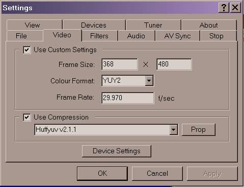

    I've attached a picture of my settings for VirtualVCR. I would definitely use the custom settings. You also need to decide what resolution you want to use. If you want to burn the capture to DVD, you should use a half D1 resolution (352x480). I capture at 368x480 because of some peculiarities with my capture card, but I also crop it down to 352x480 as I'm capturing using VirtualVCR's video cropping filter.

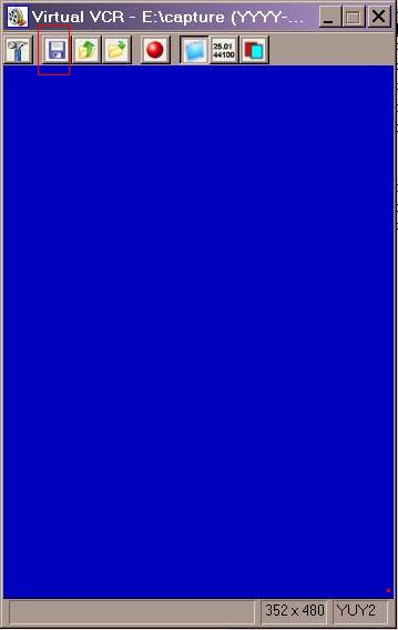

    You can save your settings by clicking on the icon that looks like a floppy disk after you have everything set the way you want it.

    YUY2 should be an option in your "colour format" drop down. Notice that it is a drop down with a scroll bar. Not all of the options show when you click the down arrow, but you should be able to scroll through all the options with the scroll bar once you click on the down arrow. If you want, you can use the rgb24 color format instead.
    Huffy will become an option if you download and install the huffy codec. It is a nearly lossless codec that will capture to an avi. But note you will need a LARGE hard drive with lots of space to capture using this codec. Aproximately half a gig per minute.
