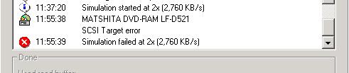

    I used forceaspi and it seemed to work but only for a few days, for the past couple of months, the Burner hasn't been working.
    The same error message on Nero :-
    and now on Roxio DVD Builder, this picture at this comes up when I try to load it up, is this anything to do with my problems?
    You can find more information in the other thread (link at top of post), I've tried frcaspi again but it doesn't work.
    I hope this post made sense and if it did, Please help me!!

  4. I did what you said and tried with DVD Shrink.
    Windows 2000 5.0
    WinAspi: File 'Wnaspi32.dll': Ver=4.60 (1021), size=45056 bytes, created 10/09/1999 12:06:00
    ahead WinASPI: File 'C:\Program Files\Ahead\Nero\Wnaspi32.dll': Ver=2.0.1.50, size=131072 bytes, created 25/06/2002 17:34:54
    Nero API version: 5.5.9.17
    Using interface version: 6.0.0.0
    Installed in: C:\Program Files\Ahead\Nero\
    Application: ahead\Nero - Burning Rom
    Recorder: <MATSHITA DVD-RAM LF-D521>Version: A112 - HA 1 TA 0 - 5.5.9.17
    Adapter driver: <atapi> HA 1
    Drive buffer : 2048kB
    Bus Type : default (0) -> ATAPI, detected: ATAPI
    === Scsi-Device-Map ===
    DiskPeripheral : Maxtor 6E040L0 atapi Port 0 ID 0 DMA: On
    CdRomPeripheral : MATSHITA DVD-RAM LF-D521 atapi Port 1 ID 0 DMA: Off
    CdRomPeripheral : PIONEER DVD-ROM DVD-117 atapi Port 1 ID 1 DMA: Off
    AutoRun : 1
    Excluded drive IDs:
    CmdQueuing : 1
    CmdNotification: 2
    WriteBufferSize: 24117248 (0) Byte
    ShowDrvBufStat : 0
    EraseSpeed : 0
    BUFE : 0
    Physical memory : 158MB (162288kB)
    Free physical memory: 59MB (61260kB)
    Memory in use : 62 %
    Uncached PFiles: 0x0
    Use Static Write Speed Table: 0
    Use Inquiry : 1
    Global Bus Type: default (0)
    Check supported media : Enabled (1)
    8.2.2004
    NeroAPI
    18:22:53 #1 Phase 111 File APIProgress.cpp, Line 256
    DVD-Video files sorted
    18:22:54 #2 Text 0 File Reader.cpp, Line 115
    Reader running
    18:22:54 #3 Text 0 File Writer.cpp, Line 126
    Writer MATSHITA DVD-RAM LF-D521 running
    18:22:54 #4 ISO9660GEN -11 File geniso.cpp, Line 4485
    First writeable address = 0 (0x00000000)
    18:22:54 #5 ISO9660GEN -11 File geniso.cpp, Line 4485
    18:22:54 #6 Text 0 File Burncd.cpp, Line 3597
    Turn on Disc-At-Once, using DVD media
    18:22:54 #7 Text 0 File ThreadedTransferInterface.cpp, Line 659
    Setup items (original item values)
    0: TRM_DATA_MODE1 (CTransferItem)
    2 indices, index0 (150) not provided
    original CD pos #0 + 2253689 (2253689) = #2253689/500:49.14
    relocatable, CD pos for caching/writing not required/required, no patch infos
    18:22:55 #8 Text 0 File DlgWaitCD.cpp, Line 203
    Last possible write address on media: 2298495 (510:48.45)
    Last address to be written: 2253688 (500:51.13)
    18:22:55 #9 Text 0 File DlgWaitCD.cpp, Line 208
    Write in overburning mode: FALSE
    18:22:55 #10 Text 0 File DlgWaitCD.cpp, Line 1420
    Recorder: MATSHITA DVD-RAM LF-D521;
    CDRW code: 00 00 00 00; CD manufacturer unknown
    ATIP Data: ?
    18:22:56 #11 Text 0 File ThreadedTransferInterface.cpp, Line 811
    Prepare recorder MATSHITA DVD-RAM LF-D521 for write in cue-sheet-DAO
    DAO infos:
    MCN:
    TOCTYPE: 0x0 Session Closed, CD fixated
    Tracks 1 to 1:
    TRM_DATA_MODE1, 2048/0x0, ISRC "", FilePos 0 307200 320894976
    18:22:56 #12 Text 0 File ThreadedTransferInterface.cpp, Line 659
    Setup items (after recorder preparation)
    -> TRM_DATA_MODE1, 2048, config 0, wanted index0 0 blocks, length 2253689 blocks [MATSHITA DVD-RAM LF-D521 ]
    18:22:56 #13 Phase 24 File APIProgress.cpp, Line 256
    Caching of files started
    18:22:56 #14 Phase 25 File APIProgress.cpp, Line 256
    Caching of files completed
    18:22:56 #15 Phase 36 File APIProgress.cpp, Line 256
    Burn process started at 2x (2,760 KB/s)
    18:22:56 #16 Text 0 File ThreadedTransferInterface.cpp, Line 1953
    Verifying CD position of item 0 (relocatable, CD pos, no patch infos, orig at #0): write at #0
    18:22:56 #17 Text 0 File Mmc.cpp, Line 16757
    Set BUFE: supported -> ON
    18:22:56 #18 Text 0 File Cdrdrv.cpp, Line 7293
    ---- DVD Structure: Physical Format Information (00h) ----
    Layer: 0, Address: 0 (0 h), AGID: 0; Length: 2050
    Book Type: DVD-R (2), Part Version: 5
    Disc Size: 120 mm, Maximum Rate: <not specified> (F h)
    Number of Layers: 1, Track Path: Parallel Track Path (PTP), Layer Type: recordable
    Linear Density: 0,267 um/bit, Track Density: 0,74 um/track
    Starting Physical Sector Number of Data Area: 30000 h (DVD-ROM, DVD-R/-RW, DVD+R/+RW)
    End Physical Sector Number of Data Area: 30000 h
    End Sector Number in Layer 0: 0 h
    Data in Burst Cutting Area (BCA) does not exist
    18:42:06 #19 SCSI -400 File Cdrdrv.cpp, Line 1388
    SCSI Exec, HA 1, TA 0, LUN 0, buffer 0x07C10000
    Status: 0x04 (0x01, SCSI_ERR)
    HA-Status 0x00 (0x00, OK)
    TA-Status 0x02 (0x01, SCSI_TASTATUS_CHKCOND)
    Sense Key: 0x04 (KEY_HARDWARE_ERROR)
    Sense Code: 0x03
    Sense Qual: 0x01
    CDB Data: 0x2A 0x00 0x00 0x16 0x9E 0xE0 0x00 0x00 0x20 0x00 0x00 0x00
    Sense Data: 0xF1 0x00 0x04 0x00 0x16 0x9E 0x70 0x0A
    0x00 0x38 0x00 0x00 0x03 0x01
    18:42:06 #20 DVDR -400 File Writer.cpp, Line 334
    SCSI Target error
    18:42:06 #21 Text 0 File ThreadedTransfer.cpp, Line 219
    all writers idle, stopping conversion
    18:42:07 #22 Text 0 File ThreadedTransfer.cpp, Line 213
    conversion idle, stopping reader
    18:42:07 #23 Phase 38 File APIProgress.cpp, Line 256
    Burn process failed at 2x (2,760 KB/s)
    18:42:07 #24 Text 0 File Scsicmd.cpp, Line 402
    SCSI not using temporary buffers
    20 out of 20 temporary buffers allocated
    Existing drivers:
    File 'Drivers\CDR4_2K.SYS': Ver=6.0.0.171 , size=59760 bytes, created 13/01/2003 09:19:26
    File 'Drivers\CDRALW2K.SYS': Ver=6.0.0.171 , size=24839 bytes, created 13/01/2003 09:19:26
    File 'Drivers\ASPI32.SYS': Ver=4.60 (1021), size=25244 bytes, created 10/09/1999 12:06:00
    File 'WNASPINT.DLL': Ver=V1.18, size=57344 bytes, created 12/06/2003 07:00:00
    Registry Keys:
    HKLM\Software\Microsoft\Windows NT\CurrentVersion\WinLogon\AllocateCDROMs : 0 (Security Option)
    Does that give any more hints why it doesn't work? It's just a load of cr@p to me
