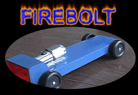

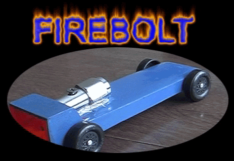

Here are some screen capture of the finnished Mpegs. The captures were done in Vdub, so no bob filters were used.
Interlaced Version
Progressive Version
You can see the difference in the flaming text.Got my retirement plans all set. Looks like I only have to work another 5 years after I die........ -
Your text is PROGRESSIVE overlayed on INTERLACED video. This is what your problem is. The rest of the pictures look virtually the same (to my eyes).
Can the text be converted to INTERLACED? Don't use P6.5, so I don't know about this. If not, just encode as progressive. The only places where you might have problems is at scene changes.ICBM target coordinates:

Actually the text is animated 3-D that I created in Ulead Cool 3D then saved as AVI video(not sure if it is progressive) uncompressed RGB. I then overlayed it over the video and matte, then set transparency. If you see that scene on a TV and pause it, you will see well defined jagged edges in the oval cutout of the black matte on the Iterlaced video. The progressive video looks perfect when paused an the TV.
