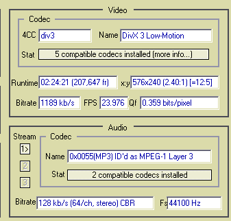

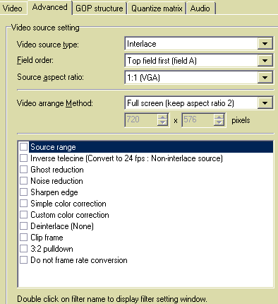

I see you have Video source type as interlace on the advanced tab. Are you sure the avi is interlaced. Avi's are commonly divx or xvid codecs and I have yet to see one which is interlaced. DV Avi is normally interlaced though. It might help if you also post a gspot screenshot of your source avi.
here it is. how do you see it's inerlaced?
Come to think of it, ik wonder if I didn't set it myself to interlaced. What diff does it make. I've read guide about this bu t none make a big deal of it so I never thought it mattered too much. I know it has something about how the vertical & horizentall lines are displayed in the movie??

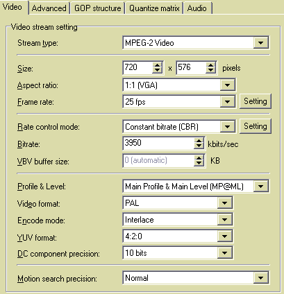

One of your problems is that you are taking a 23.976fps NTSC film frame rate) source file and encoding it to 25fps (PAL frame rate). This will cause the jerky motion you describe.
Either encode it as NTSc at 23.976fps with 3:2 pulldown enabled or do a proper framerate conversion which means speeding up the movie to 25fps and adjusting the length of the audio to match the new video. Loads of threads and guides on how to do this.
The pixelation could be caused by too low a bitrate especially if during actions scenes. Try encoding using 2-pass VBR with MAX 8000, Average 3900 (same as your CBr value) and min 2000. Or use CQ mode, though its difficult to predict final filesize this way. -

Framerate conversion: You can do this in Tmpgenc (video only). Set everything exactly as before but on the advanced tab tick the box that says 'do not framerate convert'. This means tmpgenc will encode your 23.976fps source to 25fps without inserting extra frames (which cause the jerkyness). The result is slightly speeded up video. Not enough for the viewer to notice (film is encoded to PAL this way) but the audio is now the wrong length so you have to shorten it. You can use goldwave or besweet to do this).
