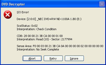

  1. I've had my dvd burner for about a month and burned 15+ dvd's with no trouble. All of a sudden everyone I burn does not work!
    I've tried rebooting, shutting completely down. I've tried burning with Nero 6, DVD Decrypter, DVD Shrink 3.1, nothing seems to work now.
    I get the following error when trying to read the disk with DVD Decrypter, any help would be great. Thanks.

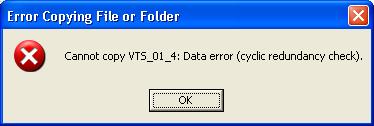

    Have you tried to just drag and drop the data off the disc to your hd using windows explorer. If you can't read the whole disc then it may point to a particular data error on the disc. If it works then it's not the drive or the media so you can start looking at a program driver conflict from something you installed recently.
    Take it step by step.
  3. Thanks for the reply, tried and failed:
  4. Hate to state the obvious, but it looks like your burner has crapped out. Are you able to read CDs or any other media?
  5. I still have no trouble reading disks. No problems ripping and playing from the HD.
