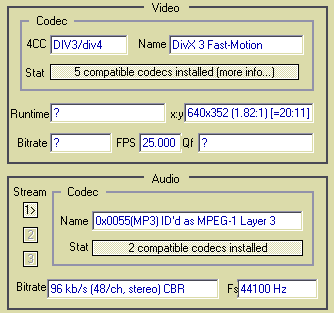

Hi there, could someone please explain this issue with G Spot?
Where do the question marks come from and how is it possible that the info isn't there. How can I get the bitrate?
Is there the info in the AVI or is the header screwed up maybe.
Hi and thanks for your reply. I like you South Park guy, cool icon.
Unfortunatly your suggestion didn't work.

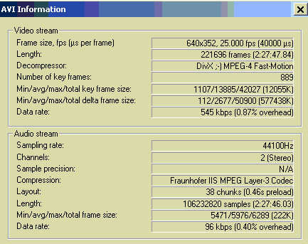

I got the app and ran it thru the AVI and got a file called DivFix. file.
Tried again in GeeSpots but got nothing. Then i got the idea to take a look in the file info in VDub.
Now I've never used this before... Is it the avg total key frame size that I need?
What's that delta stuff? Do you know?
I have no idea how to interpret the delta frame size either but your bitrate should be 545 kbps data rate. That sounds about right for Divx Fast Motion.
