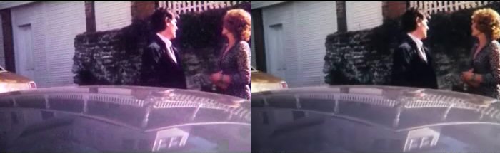

Okay, here's an example I took this while using TMPGEnc the one on the left is what I'm asking about.. The one on the right is the next frame from the same file and is normal..

It's from Big Fish and yeah... All of the downloaded movies with the MS-MPEG 4 V3 compression I have do this... Could it be the video compression for the AVI files?
My bet would be that you have the nimo codec pack installed. I had the same exact problem and the only thing I did recently was install the pack. Tonight I unistalled it...which messed up my xvid and divx stuff and my ac3 codec. After re-installing my xvid divx and ac3 stuff my initial test shows that the problem is gone.
I should know more tomorrow. Hope this gives some insight. -
HOLY BANANA! :O THANK YOU! It was that ****ing Nimo Codec pack! I could have sworn that I uninstalled it a long time ago!
