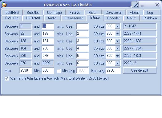

I'm trying to rip a DVD to SVCDs using DVD2SVCD. The movie is 2 hr 8 min, but it's splitting it to 3 CDs. What settings should I change to fit movie to 2 discs.

It is quite easy actually. Just go to the bitrate section and adjust the settings there. Three discs are a pain - how do you store them conveniently. I can pickup double-disc cases cheaper than singles here in New Zealand. Plus if I had to split all movies onto three discs I think I would finlly bite the bullet and buy a DVD burner (burners and media are more expensive here but prices are coming down). Sorry I'm rambling but I hope I pointed you in the right direction.
I do that all the time. Just change the bitrate settings for number of CD's from 3 or 4 to 2. Quality will suffer a little, but getting up twice to change SVCD's is too much.
thanks.. I'll give that a try. I wasn't sure if it would work if I just changed those, and didn't want to wait 3-4 hours again for the results.
