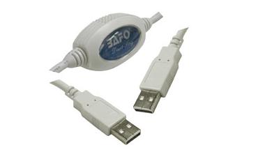

  4. Try this I guess
    This should work for you I suppose. I've never did it.
    GOod luck
