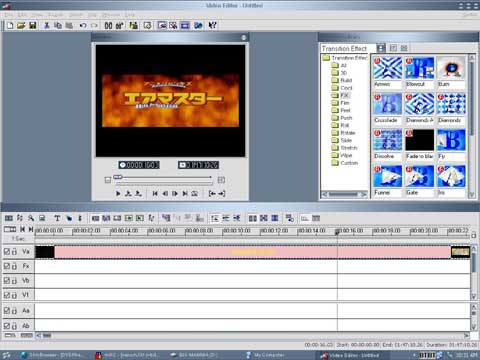

I am putting some anime fan subs on to dvd but everytime i do it it cuts the subs off at the bottom. I have used TMPGEnc to resizeit and in ulead video editor it looks fine but when i put it in ulead dvd workshop 2 it goes back to normal. can some one please tell me what i have done wrong or a better way of doing this.
