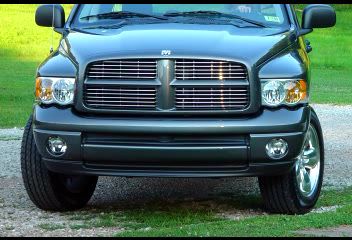

  8. It made me wonder if I would have been better off encoding at the highest bitrate allowed and using DVD Shrink to make it fit.
    I ran a few tests and here are my results. These are photos of a tight zoom area at the same point on each of the clips.
    1. Default VCD 1.150Mbps
    2. Shrunk (32.8% max setting available)
    3. Lowed bitrate encoding .505Mbps
    4. Lowed bitrate encoding .434Mbps
    The file size of the DVD Shrink version was a little less than the file size of example #3, but larger than #4.
    Full frame image from original VCD clip as reference
    Hope this helps.
    Aug 2003
    Seems to me that lower bitrate is better. But at my age I'm blind in one eye and can't see out the other
    Thanks for all your hard work. Nice truck/suv
  10. Thanks.
    My wifes 2003 Hemi. Good pickup, I like it but she won't let me drive it. haha
    I was surprised with these results. I though shrink was doing a better job, of course I shrank that VCD a bunch!!! Like 1/2 total file size or so. lol
    Good luck with everything.
