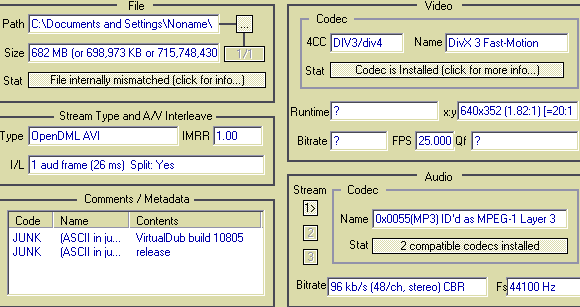

    Unable to open a file in TMPGnc or VDubb and you've used GSpot to read out your details.
    Note the Video Codec is DIV3/div4
    The DIVX5 codec will open this for you once installed onto your PC and you will be able to open it in the applications mentioned above. You'll only need the codec.
    If you get the error message below installing the codec will resolve this .dll error.
