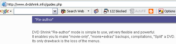

  4. Perhaps reading the guides would help...
