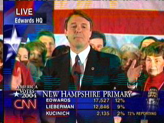

  1. I'm capturing using a Leadtek WinFast TV2000XP Deluxe card and there are some problems with MPEG-2 and MPEG-1 captures in the WinFast PVR application.
    Computer is an Athlon 900 with 768MB of RAM and a dedicated 20GB EIDE UDMA Hard Drive and Win2K Pro.
    I am not getting dropped frames, but I do get very annoying (to the point of being unwatchable) blocks of solid color (pink, green, red, blue) on my MPEG Captures. I can capture using other codecs and I do not have a problem. VirtualVCR captures with no issues.
    This problem occurs without fail whenever I capture using the MPEG-1 or MPEG-2 options in WinFast PVR. I have FDISKed and reinstalled to verify that the problem occurs on a clean system, and have had the same results. All drivers (VIA, WinFast, Promise, DirectX 9, etc.,) are the most recent updates. Normal TV Viewing is spotless; this only occurs in MPEG-1 or MPEG-2 capture (sorry to be a broken record).
    A friend of mine has a comparable system (Intel P3-933) and the WinFast TV2000 Expert card and his MPEGs do not have this problem.
    I have e-mailed Leadtek support and honestly don't expect much of a reply. I was hoping some of you could point me in the right direction on this one. I would tend to think my system is underpowered, but for the fact that my friend with a very similar setup had no such problems. That and DivX and MS MPEG4 v2 work without any issues at the same resolution.
    Please find the example photo attached. I have more examples if necessary.
    I'd sure appreciate any insight you could provide.
