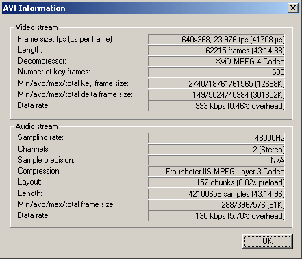

    This is what VDub has to say about the source file

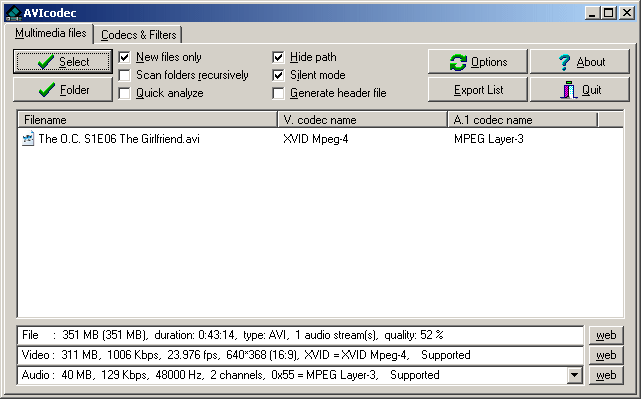

    This is what AVIcodec has to say about the source file
