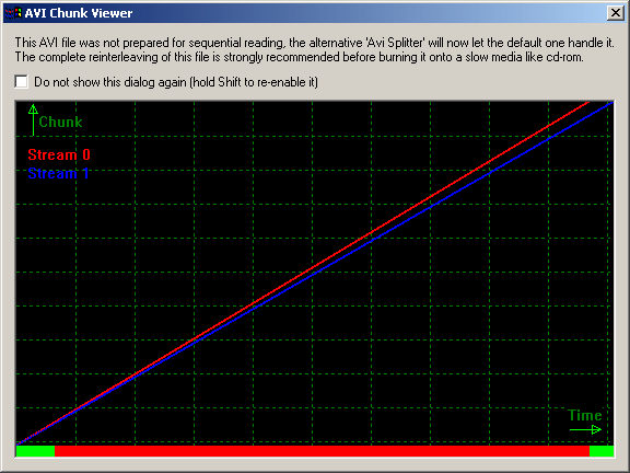

This appears when I try to play them in MPC.
I don't know whether this is related to the problem or not, but I've never seen it before with any other file I've played in MPC and I don't know what it means either. If anyone has had any success converting these particular AVI files then I would really appreciate knowing how you did it.

Funny thing about MPC is that I cannot get any divx/xvid w/vbr mp3 audio to play in sync, but Media Player 6.4.xxx and even MediaPlayer9 play those exact same files with no audio/video sync issues. But I haven't played around enough with MPC's settings so I don't think MPC is the problem. -

Yes I agree this is strange. This is the only other consistent thing that I'm finding with these files. To date, MPC has been able to play everything I've thrown at it perfectly - and TMPGEnc has been the same in that it has converted everything I've thrown at it no problem. Now all of a sudden, I've got these O.C. episodes which both MPC & TMPGEnc are having huge difficulties with. PowerDVD is the only thing I can get so far to play them properly. If there was a way to frameserve to TMPGEnc through PowerDVD, I might have a solution.Funny thing about MPC is that I cannot get any divx/xvid w/vbr mp3 audio to play in sync, but Media Player 6.4.xxx and even MediaPlayer9 play those exact same files with no audio/video sync issues. But I haven't played around enough with MPC's settings so I don't think MPC is the problem. -
