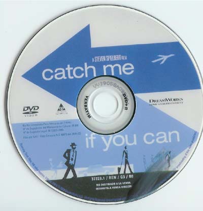

Here is a pic (if it uploaded correctly) of a Verbatim Inkjet/Thermal disk that I printed on the R300.
It dried overnight (about 12 hours). I wet my finger and slid it acrossed the dvd, and as you can see, it smeared very easily. The print is awesome, but the ink is very easily removed. I have some Riteks coming in today. I want to see if there is a difference in media. By the way, this is my first dvd that I printed using my new R300.
