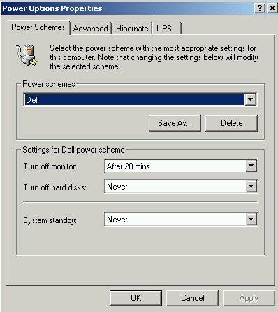

Yeah, turn off your power scheme. You computer is hibernating because it's idle (idle is defined as no keyboard/mouse input).
Right click in the middle of your screen (not on something, this is a test). Select properties, then Screen saver, then hit the power button. Set it to not turn off your Harddrive or shutdown, like the picture.

It sounds like just your monitor is cutting off due to your power scheme settings, not your computer, so the encoding should be continuing even while the monitor is off.
I agree with Gazorgan - but also set your power scheme so that your monitor does not turn off. That way, you can monitor a long encode by manually switching your monitor on and off without having to strike a key or move the mouse to get the monitor to switch back on.
