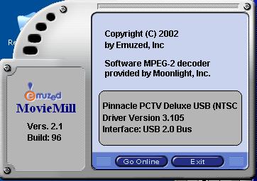

Hi all again,
Movie Mill says - at its about tab - that my connection is USB 1.1 and not 2.0;
I instaled the alternative Emuzed driver posted above by Don Pedro, but with either driver (Original Pinnacle 1.6 or Emuzed), MM says that my connection is 1.1.
I guess the problem lies on my Windows instalation, cause at the driver (either one) instalation step, it advises me that my connection is 1.1 and the Pinnacle unit is 2.0;
I have SP1 instaled, which is supposed to install 2.0 support, I have onboard USB connectors (no PCI card);
ANY GUESS ??

Zetti,have you gone into bios and checked to see if usb 2.0 is enabled?What motherboard do you have?
I think,therefore i am a hamster. -
Try SiSoftware Sandra to see what kind of port it realy is.
Did you connected it directly to motherboard or are you using some kind of HUB ?
Is thsi the MOBO that you have ? ASUS A7N8X DeluxePinnacle Studio 8 and DV home video editing (ver.9 already home) -
Non. It's freezing after while so It is unpluged as it was before.....Originally Posted by Zetti
Thanks to all, fixed that through anothert tip;
