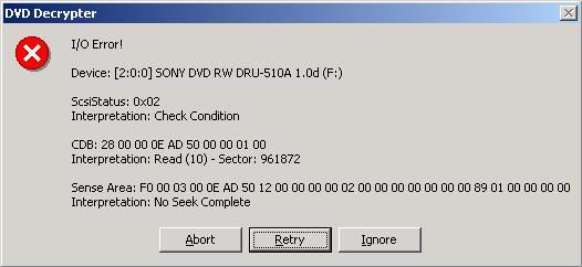

  5. So does that mean if I get this kind of error no reader can help?
    No, not at all. My crappy old DVD-ROM gave me that error and many more. The Pioneer is purring like a kitten.

  7. Will a combination of ISOBuster and the Pioneer drive work better than the software alone? I am trying ISOBuster with the DRU510A as I type this, and the sectors are still not being read...

  8. OK, I installed a Pioneer DVD-120 last night, and it still didn't read the scratched DVD... Seemed to be stuck on one bad sector and wouldn't go on. I even tried once again to repair the media first, and it didn't help either. Should I look into another brand of DVD-ROM, or if the DVD-120 can't read it, no other ones can?
