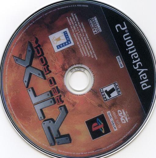

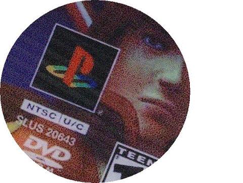

    I bought an R300M and have printed about four Dvd's. Two of the four show this banding issue. There are two distinct 1 1/2 inch strips that show one on the left and one on the right side of the printed cd. 3 of the Dvd's were printed with the Epson software. The other was using Acoustica Cd Labeler. The one using this software did not show the bands. However I did notice the quality of printing was of lesser quality. It seemed to cause pooling of the ink.
    I am using 4x Bealls Printable. It's hard to capture the banding on my scanner. It doesn't seem to want to pick it up. But as described before, it's as if scotch tape was pulled off and left the residue behind. I'm going to try and use nero's program and see if that fixes the problem. Here is the pic of Acoustica's printing job
    This one is printed with the Epson software and doesn't show the banding. It also produces a lot better results than Acoustica's software
