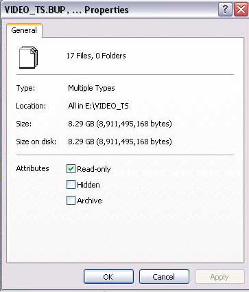

yeah thats right, i used my philips dvdr70 recorder to record 3 vcds onto 1 dvd. i then went to ripp the created dvd to my hdd and found that the files i had just ripped off the said dvd were 8.4 gig in size. here is the proof.
the thing is, i now cannot burn that dvd+rw to a 4.7 gig dvd+r.
the questions i have are how and why?
i realise this could also be posted in the dvd to dvd section but since it was recorded on the dvd70 recorder i thought i would post it here first and if i got little response then i would post it in dvd to dvdr.
anybody had experience of this and why it occurs?![]()

what process did you use to rip the dvd to your hard drive? are you sure the dvd-rw was burned correctly in the philips? have you watched the whole thing without errors?
i used dvddecryptor 1st in file mode to rip then when i couldnt burn the video folder in nero i tried ripping with decryptor again but in iso mode and that created a read error at about 60 per cent into the ripping process so it couldnt ripp it. i was wondering, since the first two films i recorded on the disc were recorded in 6 hour mode, then the last film i put on the disc was in 2 hour mode, i wonder if that is waht is causing the problem. but even so i cant see how i fit 8 gig on a 4.7 gig disc.
the dvd+rw disc plays all the way through on my dvd player and on my dvd burner. -

I am surprised that DVD Decrypter gave a read error in ISO mode. I have noticed that when I record a DVD partly in SP mode, and partly in EP mode, Windows shows 8 meg of files on the DVD. But just clicking on properties for the disk shows the correct 4.7 gig. Play the .vob files and you will see that the disk contents are being listed twice - it has something to do with multiple titles recorded at different rates. DVD Decrypter has been able to read and write these disks in ISO mode for me with few problems. I did a read failure with one DVD+RW disk, but at 98% of the disk. I assumed it was media failure. I'm still experimenting with this but I think DVD decrypter should work - try another disk and see.
