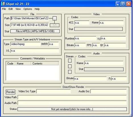

Why not? It says that it's not a MPEG file. I thought MPG and MPEG is the same thing?
Not only that but it wont load in the project wizard. Why not?

Okay, I went there and this is what happened.
Didn't work.Try first to change the directshow codec reader priority settings in TMPGEnc under Option->Environmental settings->VFAPI plug-in and right click on the DirectShow Multimedia File Reader and increase the priority to 2 or to the top of the plugin-list and try reopen the video.
I tried that. And i loaded it in AVIcodec and it shows A LOT of codecs and filters. Problem is, I don't know which ones I should download and which ones I shouldn't.If that does not help be sure that you have installed DivX or XviD or MPG2 or DV Codecs (https://www.videohelp.com/tools.php?listall=1#codecs), read here how to identify what codecs you need. -

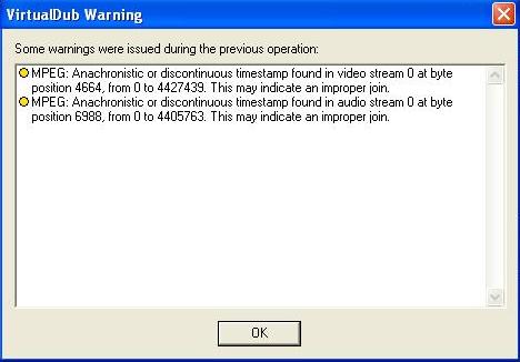

I know we probably covered this before, but when you used Virtual Dub, did you use Virtual Dub, or Virtual Dub mod?

Oh, I made a mistake. i used VirtualDubMod, not VirtualDub. When I tried with VirtualDub I got thisOriginally Posted by Tommyknocker
