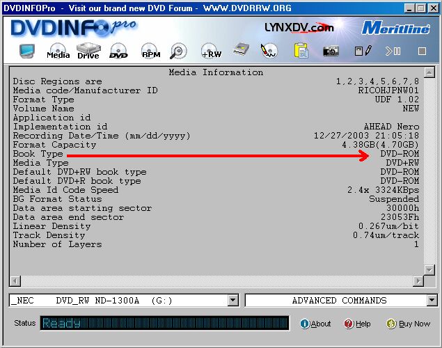

    Use DVDinfo Pro and click on the Media/info tab.
    The "Media type" will still show as DVD+RW but the "Book Type" should now show DVD-ROM.

    I have the NEC1300a and 1.08v2 and DVDinfo pro will show the altered book type. I set it in DVDinfo by formatting the disk then use nero to burn the movie. Nero doesn't show the book type but after the burn I run DVDinfo and the book type is shown as DVD-ROM. The only reason I do this of course is because one of my standalone players only recognizes the DVD+RW if I change the book type to DVD-ROM.

    tompika:
    I need to correct something I said.

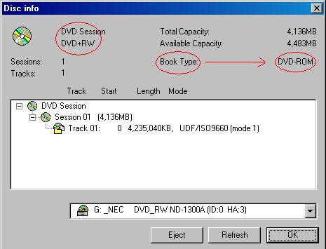

    Actually Nero will show the book type. What I meant to say is that Nero will not display the menu to set the book type. That is why I use DVDinfo to do that.
    DVDinfo also shows the book type ad will also set it.
