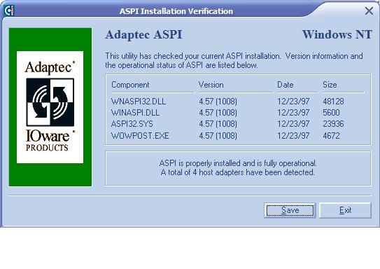

To answer the ASPI question, here's what I have installed on WinXP Pro. Not the latest, but if it ain't broke ...

Yeah -- server is being stubborn -- would not take a GIF, but worked w/ a JPG. It's up now.
Try running KILLASPI.BAT, re-boot and then re-install using FORCEASPI. -
I'm sorry I noticed that your aspi version says 4.57. Where would I find that version because the earliest I could find is 4.70. Thanks
Hi I noticed that when I installed the ASPI layer you recommended it says ASPI fully operational, and 2 host adapters are detected. I noticed that yours says 4 host adapters found. Will this make a difference? Thanks
When I get home from work I will try dvd2svcd, and see if it works like it used to. -
Not really sure. I do have 2 VIRTUAL ATAPI drives defined/configured in addtion to the 2 physical ATAPI drives. My guess is that the virtual ones show-up as a HOST ADAPTER, as well.
Give it a try and post-up. While the issues you described w/ DVD2SVCD could be caused by ASPI drivers, I am not totally convinced that this is your problem, I am hopeful that this will fix it for you. -
Thanks Ripper2860. I just used dvd2svcd to convert a movie, and it worked without a hitch. I'm just wondering if it has anything to do with cbr, multipass vbr, or one pass vbr because I used multipass(2) vbr. Before I was trying to use one pass vbr with the plugin you recomended, and it would freeze up.
