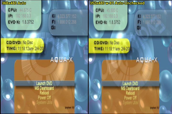

    I did just that and here is what I got. Well not exactly, 51 seemed way to soft and so I upped it to the max value 81 and I still came up with results opposite to what you suggest.
    Maybe I'm missing something here but I think my card's (OLD PCTV Pro w/Btwincap drivers) is going to want to disagree with you. Even in fmctm1sw's post the text in the 352x480 and 368x480 captures with the value of 50 shows a distinct difference in sharpness. The "Survivor: All-Stars" text is much more pleasing to my eyes in the 368x480-50 picture than the slight-hazy-blurry 352x480-50 cap.
    So based on several tests I did (H:352,368 S:49,50,55,81)and with some help from fmctm1sw's post, it seems like 368x480 does have a sharper picture than 352x480 with the same sharpness setting; be it 49, 50, 55, 81, or auto.
    The text to me on the left looks much sharper than the text on the right.

  8. @deadpac
    The difference (in my NTSC experience) between 368 and 352 is the vertical. You can see this in your pic in the word "Power". 368 does not have a vertical filter applied. 352 does. Even though you do not resize on the vertical, the filter is turned on for 1/2 D1. It blurs on the vertical. In my opinion, VHS vertical is even better.
    This was my original point. I have not been following all of Stat's results. I assume he is happy with what he gets. I'm not sure what happens on all of the variations of cards and drivers. It is easy to find out, I posted a link above that allows you to look at the exact options set for the chip. One can of course just do some test caps also. I'd recommend a resolution chart. AVIA or Video Essentials are disc with these, or you can make one from free patterns on the net. The problem jumps out on a thin horizontal line.
