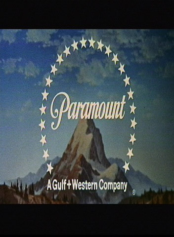

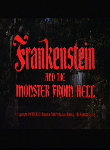

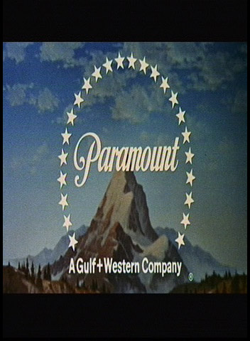

    I haven't tried capturing at 368x480 but when I first got my AverTV Stereo I tried capturing at 352x480 and I noticed that the image did not match the original.
    Let me explain that ...
    I recorded some stuff from the SCI-FI CHANNEL and the SCI-FI logo (which is in the lower right hand side of the screen) was closer to the right edge of the screen with my 352x480 capture than on the original broadcast. This was on the same TV so it wasn't a TV overscan difference between two different televisions.
    I finally found that capturing at 704x480 and adding 8 pixels of black to the sides (making it 720x480) looked good both at that resolution for Full D1 as well as looking good when resized from 720x480 (with black sides) to 352x480
    When I say "looked good" I mean the aspect ratio looked about the same as the original with the SCI-FI logo being in about the same spot on the TV screen as per the original broadcast.
    So ...
    If 352x480 had an "off" aspect ratio then surely 368x480 cropped to 352x480 would be off even more. Hell the SCI-FI logo might even get clipped a bit on the right hand side by the TV overscan.
    Now maybe resizing 368x480 to 352x480 might look OK aspect ratio wise as I haven't tried it but if I have to resize it then I figure I'm better off capturing at 704 and padding to 720 then resizing to 352x480 which is what I do now.
    BTW I resize in AviSynth using: LanczosResize(352,480)
    So I dunno right now I might try a sample clip at 368x480 resized to 352x480 and compare it to 704 padded to 720 resized to 352x480 and see which looks more proper aspect ratio wise as well as sharpness wise.

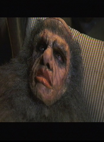

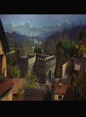

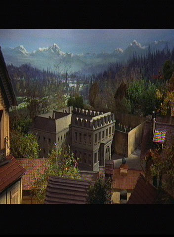

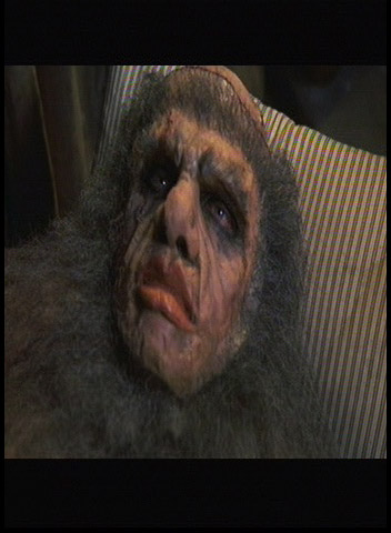

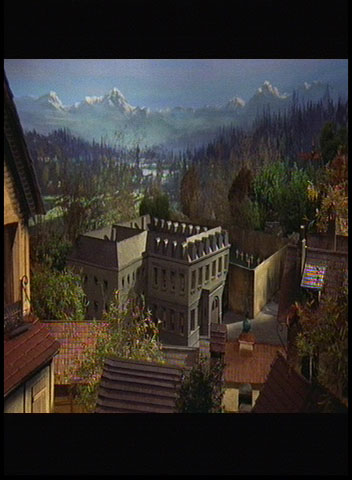

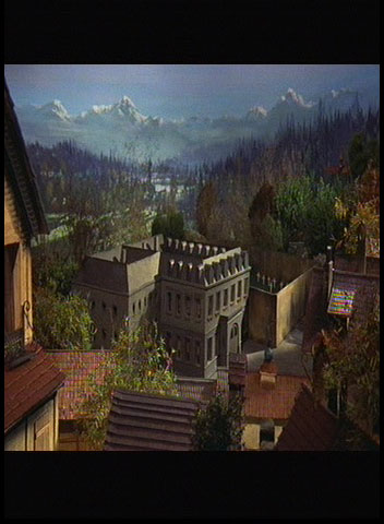

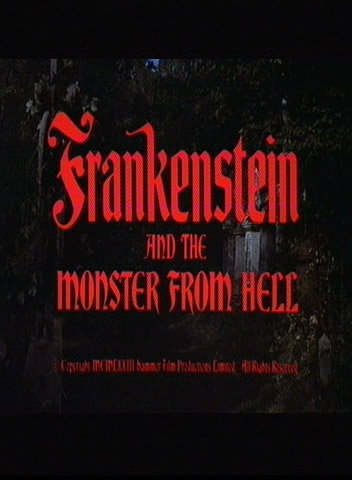

    I just stop by this thread and decided to do the test myself. I have a PixelView Play TV Pro, another BT878 card, and I am using the BTWinCap drivers. I capture using virtualVCR and used avisynth to put images side by side and subtitle. I captured Sky Digital interactive menu
    Using 352x480 I couldn't even read the text. 368 is definatelly the best, followed closely by 704x480 nearest neighbor resized to 352, which has some "stairs" effect. Using bicubic to resize makes the stair dissapear, but on the other hand, blurs the picure. This is very interesting, I'll stick with 368 from now on.

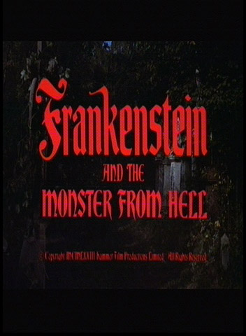

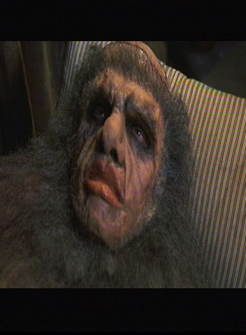

    OK here are some captures I did with screen shots.
    Source was the USA NTSC DVD of the Hammer film FRANKENSTEIN AND THE MONSTER FROM HELL
    Played this back on my Cyberhome CH-DVD 500 and connected it to my AverTV Stereo PCI capture card using composite video
    Captured the same clip twice once at 704x480 and again at 368x480
    The captures were read into VirtualDubMod using an AviSynth script for resizing and/or cropping and I copied and pasted the images into Adobe Photodeluxe Home Edition and saved them as TIFF files. I then loaded each TIFF and created JPEG files using 7 out of 10 on the quality slider with 10 being best. The pics are JUST under the 50k limit.
    PIC1_A using 704x480 capture
    AviSynth script
    LoadPlugin("C:\PROGRA~1\GORDIA~1\mpeg2dec3.dll")
    avisource("D:\test704.avi")
    AddBorders(8,0,8,0)
    Basically I'm padding the 704x480 to 720x480 then resizing that to 352x480 ... this is how I normally do my captures when using Half D1 in the end. If I'm not doing Half D1 but instead Full D1 then I use the same script but drop the LanczosResize line making the resolution 720x480
    PIC1_B using 368x480 capture
    AviSynth script
    avisource("D:\test368.avi")
    Here I simply resized the 368x480 capture to 352x480
    PIC1_C using 368x480 capture
    AviSynth script
    crop(8,0,-8,0)
    Here I simply crop or cut 8 pixels from each side of the 368x480 capture to get to 352x480
    PIC1_D using 368x480 capture
    AviSynth script
    LanczosResize(344,480)
    AddBorders(4,0,4,0)
    Here I resize the 368x480 capture to 344x480 and then add 4 pixels of black to each side to get up to 352x480 ... I will explain why I did this in a moment.
    OK here are the pics:
    PIC1_A
    PIC1_B
    PIC1_C
    PIC1_D
    Please try to note not just differences in SHARPNESS but also the aspect ratio. I think PIC1_A and PIC1_D are the same aspect ratio wise and probably the most correct (or about as correct as it can be).
    - John "FulciLives" Coleman
    P.S.
    I'm bad. I forgot to mention what codec I used!
    PICVideo MJPEG on the 19 out of 20 quality setting with 20 being best.

    If you guys are interested the post above is only one PIC that I created from FRANKENSTEIN AND THE MONSTER FROM HELL but I have 3 more images from the film and like the first image there are the same 4 variations based on my settings.
    PIC2 is the FRANKENSTEIN AND THE MONSTER FROM HELL logo screen which has the title in very LARGE letters but also has a very SMALL line of text with some copyright info. I think because of the small text it would be worth posting.
    PIC3 is a shot of the village with a lot of detail in it
    PIC4 is a fairly close up shot of the monsters face including his shoulders and chest which are very hairy so again lots of detail there.
    Again though I will only post if you guys are interested. I'm on a 56k modem and stupid NetZero has been VERY slow for the past almost 2 weeks now even for a 56k modem. So it took me FOREVER to post these pics.

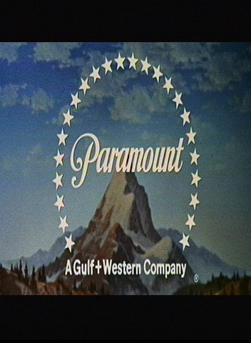

    OK here is another set of pics from FRANKENSTEIN AND THE MONSTER FROM HELL
    These were made and ordered exactly as I did the first pic (the Paramount Log) from my last pic post. Again all pics are done at 7 out of 10 but the village shot had to be done at 6 out of 10 to get it under 50k
    PIC2_A
    704x480 padded to 720x480 resized to 352x480
    PIC2_B
    PIC2_C
    PIC2_D
    368x480 resized to 344x480 then black borders added to make it 352x480
    PIC3_A
    PIC3_B
    PIC3_C
    PIC3_D
    PIC4_A
    PIC4_B
    PIC4_C
    PIC4_D
    That is the last of the pictures I have to offer.
    P.S.
    All pics for this post have now been added. This post is finished!
