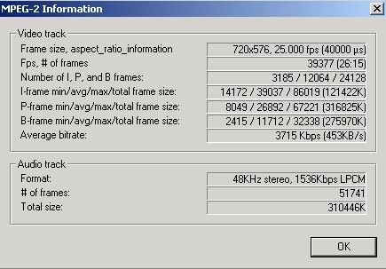

  1. I have finally dived into converting VOB's. I get a set of vob's as expected. But, why is it that the intro video clip from the dvd plays fine in media player and the BIG vob file (1 gig) plays jerky all the way through? It looks like it's playing 3 fps. I have an LPCM decoder so the audio plays fine. I was able to convert some of the video to avi in vdubmod but the result played the same. What does this mean anyway?

    Could be because Media Player sucks... Try some software DVD player to see if it gets better.
    From your screen shot, I gather it's a PAL mpeg of 26 min, 15 sec playing time, at a (for DVD) rather low average bit rate of 3715, with DVD standard LPCM audio track. Nothing unusual...
