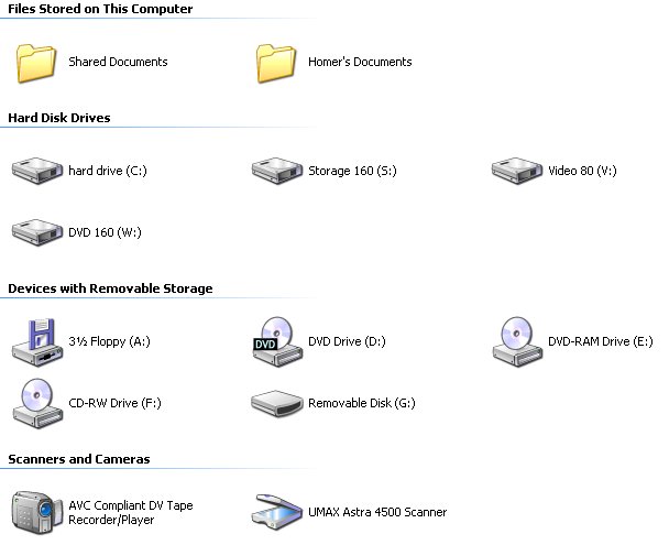

    Originally Posted by rhegedus
    ...you probably know this but when the ADVC is on, it should be listed under My Computer in windows explorer (XPpro at least).
    Yep, like this....
    Btm left of the picture.
    Will Hay

    Yep Will, that's the one I refer to in my post. The video device in My Computer. I don't get that little bugger without a lot of foolin' around with different things. I agree with most that it's probably not the Canopus but more likely a firewire/ MB problem. I'm hopeful that lzicc has some success with his new drivers.

    Ok, here's a theory; If there is no video stream into the Canopus it can't decide to switch the video out to digital, so XP doesn't recognize any input on the firewire wire. Just a thought. (and upping my miniscule post count )
  7. Member rhegedus's Avatar
    on the jazz
    I think it still shows up as connected and on but without input, but the preview screen is just blank blue.
    Yes, it does.
    The shot I uploaded was of my ADVC with absolutely no leads connected, therefore no input.

    Well, I wish that were the case with my Dim 8300. Of course it's a Dell so maybe that has something to do with it. No video device shows up in my Explorer without great gnashing of teeth. If you guys are seeing your canopus show up just by turning it on, then it has to be a driver problem IMHO.
