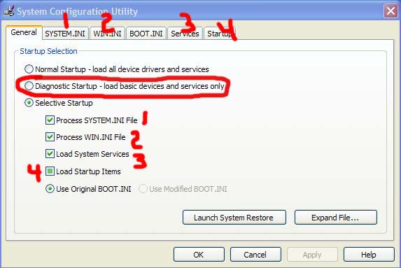

Maybe you should either list or screen capture your startup tab in msconfig utility or maybe your add and remove programs window.
Don't go uninstalling software all over the place unless you don't want it anymore. Incidently, you don't need "tweak XP pro", tweak UI 1.33 will work with XP. I had a time getting rid of tweak XP pro also.
The video files played when you did a clean boot...I assume you just clicked the "Diagnostic startup" so what you should do is start > run > type "msconfig" and click "selective startup" then uncheck all the boxes below it except "Use Original BOOT.INI"
Then check mark - Process SYSTEM.INI file
Click OK and reboot. Check it again...if it still works OK then repeat the process check marking "Process WIN.INI file" next and so on until it fails. Once it fails you know where the program is starting from.

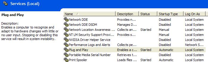

One little short cut thing and this has gotten me before, is on the services tab put a check mark in the little box at the bottom that says "hide all microsoft services" and in the services window all microsoft services will disappear and what is left could be your problem. Your video card should still be in there, but just about anything else should not be and could be causing your problem. I had some little crack headed service running that was install by some spyware BS but it was trying to access the internet every time I started a program. If I started spider solitaire it was dialing up...pain in the butt. -
Cyberpig -
An easy clean boot is to:
click the start button > run > type in "msconfig" (without the quotes)
The window that pops up is your system configuration utility.
Check marking the "diagnostic startup" will do exactly what it says...it's one step above safe mode...it starts windows very stripped down. When you check "diagnostic startup" the boxes by #'s 1,2,3,4 will be empty.
Click OK and reboot. When windows comes back up check it again and see if the same problem persists. If it does you have bigger issues, if it works then:
reboot and check again and just keep doing that until it stops working again and you will be able to determine if your problem exists in your sys.ini, win.ini. services, or startup.what you should do is start > run > type "msconfig" and click "selective startup" then uncheck all the boxes below it except "Use Original BOOT.INI"
Troubleshooting is all about narrowing it down. -
wow!, I found it!

It was by Services:
Plug&Play ...... m-i_k_r__o_ß_o-f_t .... co_r-por-at_ion !
Now I dont know what can I do with it, if I deactivate it, some program will not start or not start properly?
S_keeper -
That is how it is written??? If it's causing problems then you don't need it.Plug&Play ...... m-i_k_r__o_ß_o-f_t .... co_r-por-at_ion
Unchecking it in the configuration manager will not necessarily get rid of it. Now I'm not at my XP machine...this stupid "work" thing keeps taking up so much time...
But you will need to goto - control panel > administrative tools > services
scroll to find that service and then right click on it and go to properties. When this window opens you should have the option to enable, manual, disable. - Disable it.
There should also be a tab there that will tell you what other services depend on it to be running and what services need to be running for it to work. Not that it matters much since you obviously don't want that service to be running but for educational purposes
When you disable it, there may be a program that won't work, like you said, but when that happens...you'll know which program was causing the problem. -
just tried like you said goto - control panel > administrative tools > services and when I make Plug&play disable, then nothing working, no audio, because if I go to -control panel there "Sounds and audiodevice" is gray, by systemadministrator no possible to to call the Info about all hardware, scaner also not work and so on ...., but video in WMP and Ulead Movie factory working but without audio!
Maybe simply disable this function from "Plug&play Microsft corporation"
is not possible, because it belong to the system and must be new installed?
I dont really know! What do you think?

not that it matters if you are going to go ahead and reformat, but do not disable "Plug and Play" in the services. Disable the service that is causing you problems specifically.
leave this one on automatic windows needs it. If yours is not listed in there then you need to disable it in the system configuration (msconfig) window. -
Hi,northcat_8!
Im still not reformat my HD-C:\ yet, but Im not understand what service must really isolate?Disable the service that is causing you problems specifically
Because exist the same this "two thing" Plug&Play which resided:
one is here: administrative tools> services> Plug&Play
and
second is there: msconfig> services>Plug&Play Microsoft Corporation
It make the some result by disable here or there,I mean (disable by administrative tools or by msconfig), that is so if Plug&Play will disable, then function is video, but therefor is NO audio and much much other problem!
Question is: where and how exactly I must turned off this
service Plug&Play Microsoft corporation?
Skeeper -
You said:
This is not a valid microsoft service.Plug&Play ...... m-i_k_r__o_ß_o-f_t .... co_r-por-at_ion
This one is.Plug&Play Microsoft Corporation
Which is it?
If that is really the name of the service or is that you being sarcastic showing your frustration with Microsoft in the first one?
There is a difference where you disable services. If you disable them throught the msconfig interface then you are preventing the service from starting at start up but the service can still start if windows needs it. If you disable the service from the administrative tools interface then you are preventing the service from starting at all and if windows needs it, whatever it needs it for won't work.
If your spelling in the quote is correct then disable it in the msconfig interface. As that is not a real microsoft service and probably won't be listed in the administrative tools.
In any event, I seriously doubt that plug and play is your problem.
How did you go about figuring out it was the Plug and Play service causing the problem? If you enabled the services one at a time that is why you didn't have any sound, you have to enable "windows audio" which alphabetically would be after Plug and Play...just a random thought.
I would leave the services (check the check box that says "hide microsoft services", and then uncheck any that remain) and then clean up the "start up" tab first and your startup folder on your start menu.
If you find that it is the Plug and Play service, that means that P&P is installing some hardware that is causing the problem. The hardware isn't actually causing the problem but the drivers or shell software might be. -
