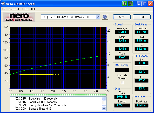

I dont agree with the results for the RICOHJPN-RO1-02 discs . I have never had problems with them . I have burned them on my Sony DRU500 AX and am now testing them on a rebadged Optorite 8X Drive ( MagicSpin ) . Here are the results of Nero CD/DVD Speed on a Ricoh 4X disc burned at 8X ( 9 min. 22 sec. ) .
[/img]
Keep it on the big cam ! -

Did you look at the graph I posted ? I have burned hundreds of Ricoh 4X discs and none have failed to write or play in a variety af players .
