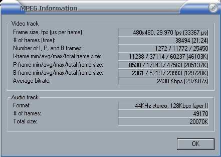

    I tried the TMPGenc plugin and two things happened:
    [a] the final mpeg played back using different software just fine.
    [b] when converted to DVD the whole final out put was fast.. not only was the video fast but the audio was not only behind the video but it as speed up.

    Using the basic orignal install setting of TMPGenc the output MPEG now shows the audio delay..???
    But the orignal file still does not show the audio delay??
    What setting do I need to change in TMPGenc??

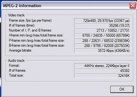

    MpegTool Repots the following about the orignal file:
    [INFO] File size: 629405696 bytes
    [INFO] SOURCE fle is not DAT format
    [INFO] Data Rate: 1604.00390625
    [INFO] Video Width: 720, Video Height: 480
    [INFO] Aspect MInfo.ratio: 0.673500001430511, Frame Rate: 29.96
    [INFO] Total Frames: 11484
    PVAStrumento reports the orignal file as:
    Found 1 video stream.
    Found 1 MPEG audio stream.
    VIDEO #1
    Resolution 720 x 480
    Aspect ratio is 4:3
    Frame rate 29.97 fps
    Nominal bitrate 4000000 bps
    First PTS: 00:00:00.000
    MPEG AUDIO #1
    MPEG1, Layer 2
    stereo, sampled at 44.1 kHz.
    Bitrate 224 kbps
    Each frame contains 26.1 ms audio (731 bytes)
    First PTS: 00:00:00.001

    Maybe getting some more detailed info about your source mpeg would shed some light on things. Since you have Virtualdub MPEG2, use it to open your original mpeg and on the File menu select "File Information". Post the info if you don't mind. The window will look like this:

    You were too fast for me, nevermind. :P If I understood you correctly, the audio de-sync level increases as the file plays?
    [/img]
    Thats what seems to be happening... on demux'ed / dvd files
    At two minutes into the file there is a spot where a pen hits paper to dot an "i" and then per the clock on the play back software counts down 2 seconds you hear the pen hit the paper.
    At five minutes into the file you see a door slam and then at 00:05:10.00 you hear the door slam..
    By this point I stop watching...
    The orignal file plays back with out audio troubles....
    Orignal file size is = 600 MB (629,211,136 bytes)
    remuxed file size is = 540 MB (566,628,356 bytes)
    But yet when I did a screen dump of the remuxed file in V-Dub-Mpeg the info windows matched to the number.
