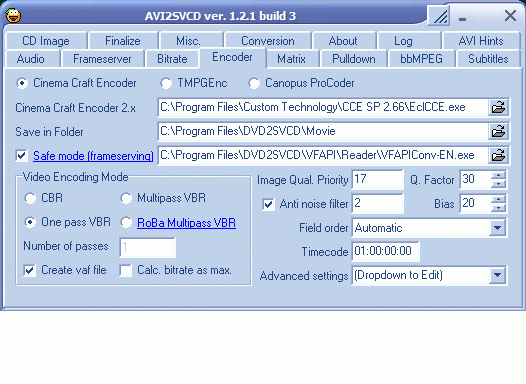

I use CCE v2.66 and have no issues. However, it is documented that if you are using anything newer than CCE 2.50 you need to enable SAFEMODE (FRAMESERVING) on the ENCODER TAB of DVD2SVCD. You will see that the CCE version field descriptor displayed on that tab will change to CCE 2.x.
