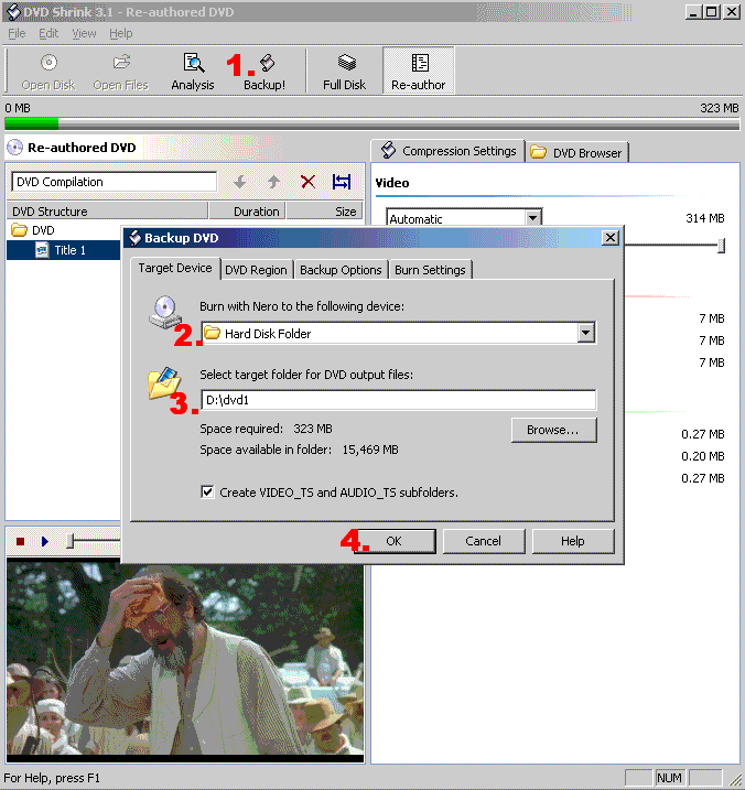

1. Click on Backup
2. Select Hard Disk Folder
3. Make a new folder
4. Hit OK to rip, it will only take a few minutes or seconds.
Repeat these steps for all DVDs. Remember to make new a folder for each video clip when you Backup.

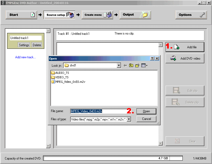

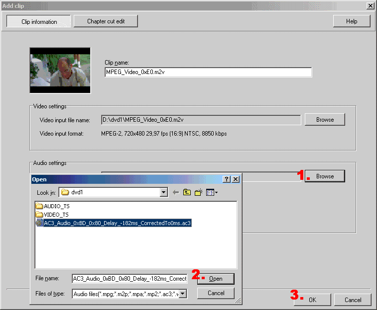

1. Select Add file
2. Select the first clip you have fixed with rejig, and open the mpeg_video.m2v file
(If TMPGEnc complaints about the bitrate just click Ignore)
1. Click on Browse under Audio
2. Add the audio clip from the same folder, the ac3audio.ac3 file
3. Hit OK

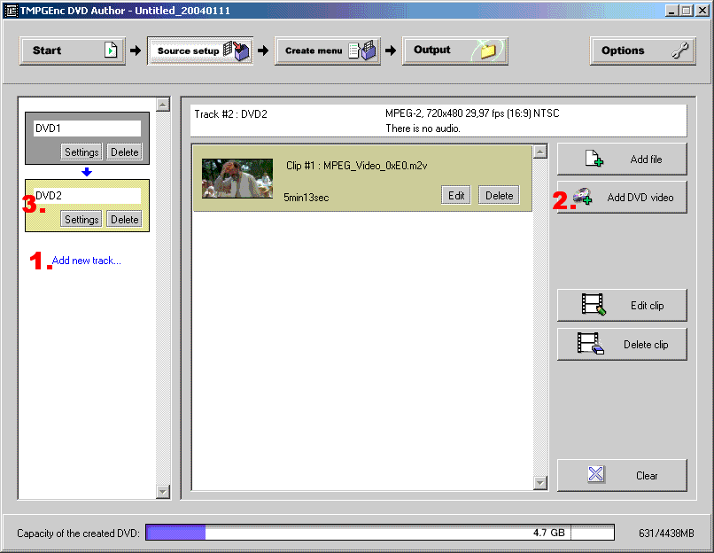

1. Click on Add new track
2. Add the DVD Video for the other DVD video clip
3. You can rename all tracks so you know what they are
Repeat these steps for all video clips.

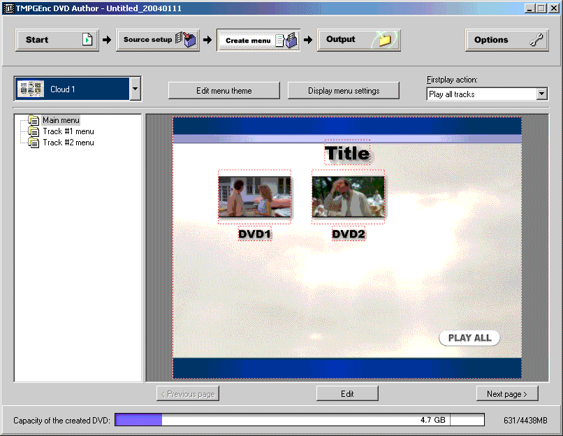

Make the menu as you want them.

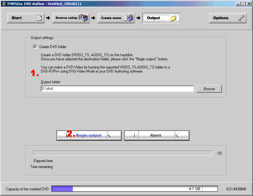

1. Select an DVD Folder output folder
2. Author

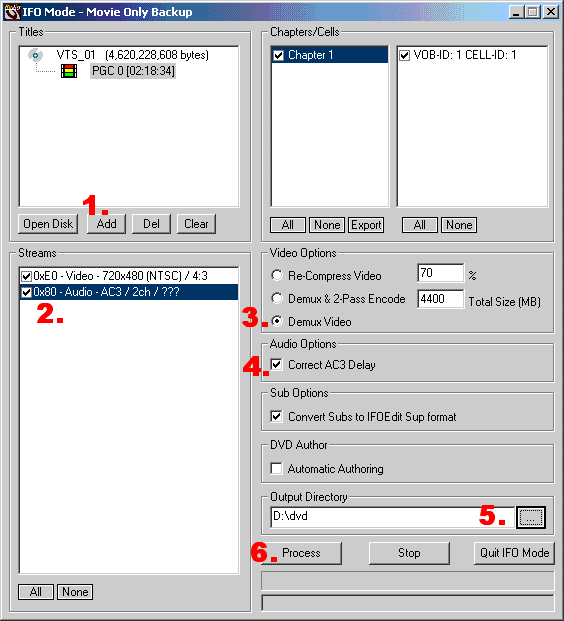

Start Rejig
Click On Ifo Mode
1. Click add and open the first dvd folder you made with dvd shrink and select the VTS_01_0.VOB file under the VIDEO_TS folder
2. Select both video and audio
3. Select Demux video
4. Select Correct AC3
5. Select an output folder, you can use same as the input folder.
6. Process and you will get an working video and audio file.
Repeat this step for all video clips folder you made with dvd shrink.

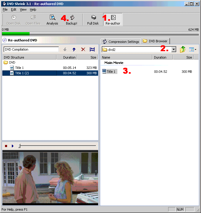

1. Select Re-author again
2. Select the first DVD clip folder you made
3. Double click on the first Title1 to add it to the DVD Structure to the left, repeat this step for all your DVD clips.
4. Hit Backup to burn the DVD
