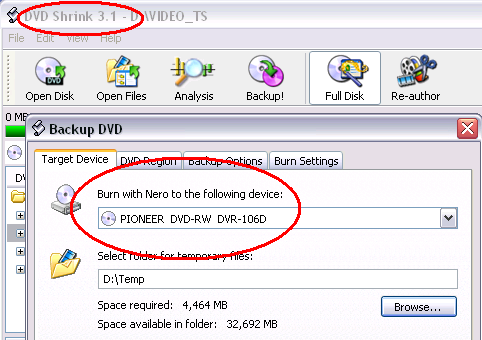

Download DVD Shrink 3.1 You don' need anything else!!!! I assume you are backing up your DVDs and not trying to process some other type of video file.
