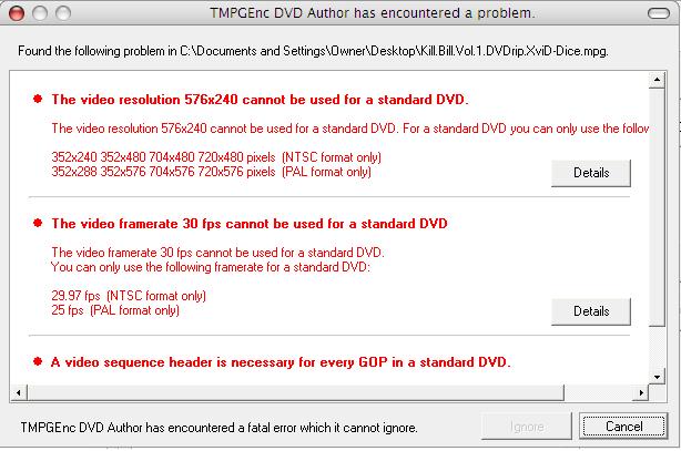

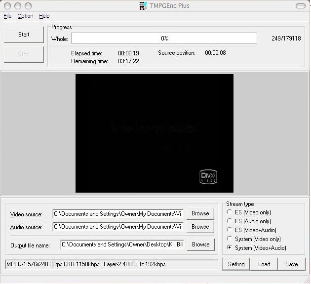

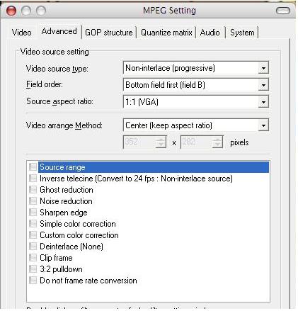

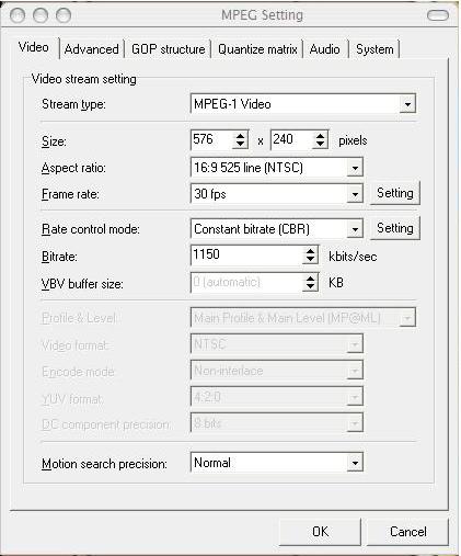

    ok my problem is that TMPGenc wont listen to my ratio, well thats what i think. i dont really it, becuase im watching a .avi file and then when i convert it to dvd mpeg-2 its all fullscreen and i said to put it widescreen and it did at frist and then i try to burn it using TMPGenc and it says it cant becuase of this dumb message
    So here is the rest to help you figer it out i've have tryed searching and still cant find any thing
    Thanks guys

  2. Because DVD have to be either 720x480 or 352x480 resolution and a frame rate of either 29.97 or 23.96 fps (in NTSC land that is).
    Plus you have it set for MPEG Layer 1.
    Read the guides over at the left hand side of the site labeled Convert.
    We could help you out more if you could post some information about the source file. Resolution, File Type, Codec, Frame rate.. etc.
    On second thought.. read some guides.
  3. In order to be DVD compliant, your resolution needs to be either:
    720x480
    704x480
    352x480
    352x240
    That is what TMPG DVD Author is trying to tell you. It is also telling you to change the frame rate to 29.97.
    The MPEG-1 is fine if you want to go 352x240. You can use MP2 (MPEG layer 2) audio but it is not technically DVD compliant if it is the only audio track. DVD compliant (NTSC) requires the use of either PCM or AC3 if you have only one audio track.
    Changing the res to 352x240 and frame rtae to 29.97 should get you a little further...

    You are changing the ratio from 4:3 to 16:9, I am assuming your source frame rate is not 30 so you are changing that also and using MPEG1 @ 1150 bitrate. These ingrediants don't sound very good. Good luck...
  5. Originally Posted by Soapm
    I think he'll be OK with MPEG-1 @1150. I have a bunch of standard VCDs on DVD (after changing the audio of course). But I agree, some of the other stuff is a little "funny."
  6. This might help you. Right from the "What is" section to your left:
    (NTSC Film)
    Video:
    Up to 9.8 Mbit/sec MPEG2 or up to 1.856 MBit/sec MPEG1 video
    720 x 480 pixels MPEG2
    704 x 480 pixels MPEG2
    352 x 480 pixels MPEG2 (Same as the CVD Standard)
    352 x 240 pixels MPEG2
    352 x 240 pixels MPEG1 (Same as the VCD Standard)
    29,97 fps (frames/second)
    23,976 fps with 3:2 pulldown = 29,97 playback fps (NTSC Film, this is only supported by MPEG2 video)
    Audio:
    48000 Hz
    32 - 1536 kbit/sec
    Up to 8 audio tracks containing DD (Dolby Digital/AC3), DTS, PCM(uncompressed audio), MPEG-1 Layer2. One audio track must have DD or PCM Audio.
    Extras:
    Menus, still pictures, subtitles and more.
    For more technical DVD-Video details read the DVDDemystified DVD FAQ section 3.4 or the mpeg.org DVD Technical Notes
