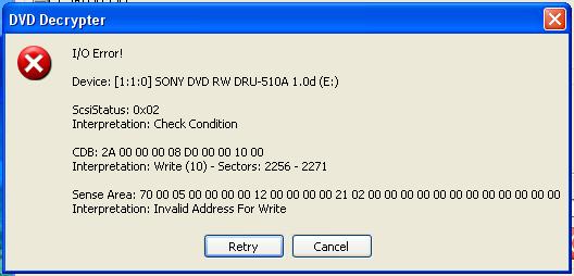

I'd really appreciate some help. I'm new to this and I should have gotten some DVD-RWs to practice on, but unfortunately only have DVD-Rs. I successfully used DVD Decrypter, then Recode 2 to shrink my files. Now I'm just trying to burn it to DVD using the latest Nero Burning ROM DVD-VIDEO using settings from a DVD Shrink guide and the burn process failed using 2x, so I tried 1x and the same thing happened. It occurs in the beginning of the burning process. Here is the last log file:
Windows XP 5.1
IA32
WinAspi: -
ahead WinASPI: File 'C:\Program Files\Ahead\Nero\Wnaspi32.dll': Ver=2.0.1.59, size=160016 bytes, created 12/16/2003 7:18:06 PM
Nero version: 6.3.0.2
Recorder: <SONY DVD RW DRU-510A> Version: 1.0d - HA 1 TA 1 - 6.3.0.2
Adapter driver: <atapi> HA 1
Drive buffer : 8192kB
Bus Type : default (0) -> ATAPI, detected: ATAPI
CD-ROM: <_NEC DV-5700A >Version: 3.07 - HA 1 TA 0 - 6.3.0.2
=== Scsi-Device-Map ===
DiskPeripheral : MAXTOR 6L040L2 atapi Port 0 ID 0 DMA: On
CdRomPeripheral : _NEC DV-5700A atapi Port 1 ID 0 DMA: Off
CdRomPeripheral : SONY DVD RW DRU-510A atapi Port 1 ID 1 DMA: Off
=== CDRom-Device-Map ===
_NEC DV-5700A D: CDRom0
SONY DVD RW DRU-510A E: CDRom1
AutoRun : 1
Excluded drive IDs:
CmdQueuing : 1
CmdNotification: 2
WriteBufferSize: 74448896 (0) Byte
ShowDrvBufStat : 0
EraseSpeed : 0
BUFE : 0
Physical memory : 511MB (523568kB)
Free physical memory: 287MB (294524kB)
Memory in use : 43 %
Uncached PFiles: 0x0
Use Static Write Speed Table: 0
Use Inquiry : 1
Global Bus Type: default (0)
Check supported media : Disabled (0)
4.1.2004
UDF/ISO compilation
3:52:36 PM #1 Phase 112 File dlgbrnst.cpp, Line 1800
DVD-Video files reallocation started
3:52:36 PM #2 Phase 114 File dlgbrnst.cpp, Line 1800
DVD-Video files reallocation completed (no file modified)
3:52:36 PM #3 Text 0 File Isodoc.cpp, Line 6029
Iso document burn settings
Determine maximum speed : FALSE
Simulate : FALSE
Write : TRUE
Finalize CD : TRUE
Multisession : FALSE
Burning mode : DAO
Mode : 1
ISO Level : 1 (Max. of 11 = 8 + 3 char)
Character set : ISO 9660
Joliet :FALSE
Allow pathdepth more than 8 directories : FALSE
Allow more than 255 characters in path : FALSE
Write ISO9660 ;1 file extensions : TRUE
3:52:36 PM #4 Phase 111 File dlgbrnst.cpp, Line 1800
DVD-Video files sorted
3:52:36 PM #5 Text 0 File Reader.cpp, Line 118
Reader running
3:52:36 PM #6 Text 0 File Writer.cpp, Line 124
Writer SONY DVD RW DRU-510A running
3:52:36 PM #7 ISO9660GEN -11 File geniso.cpp, Line 3882
First writeable address = 0 (0x00000000)
3:52:36 PM #8 ISO9660GEN -11 File geniso.cpp, Line 3882
3:52:36 PM #9 Text 0 File Burncd.cpp, Line 3101
Turn on Disc-at-once, using DVD media
3:52:36 PM #10 Text 0 File DlgWaitCD.cpp, Line 240
Last possible write address on media: 2298495 (510:46.45, 4489MB)
Last address to be written: 2283471 (507:26.21, 4459MB)
3:52:36 PM #11 Text 0 File DlgWaitCD.cpp, Line 245
Write in overburning mode: FALSE
3:52:36 PM #12 Text 0 File DlgWaitCD.cpp, Line 2085
Recorder: SONY DVD RW DRU-510A, Media type: DVD-R
Disc Manufacturer: TDKG02 - 000000
Disc Application Code: 64, Disc Physical Code: 193
3:52:36 PM #13 Text 0 File DlgWaitCD.cpp, Line 406
>>> Protocol of DlgWaitCD activities: <<<
3:52:36 PM #14 Text 0 File ThreadedTransferInterface.cpp, Line 779
Setup items (after recorder preparation)
0: TRM_DATA_MODE1 (CTransferItem)
2 indices, index0 (150) not provided
original disc pos #0 + 2283472 (2283472) = #2283472/507:26.22
relocatable, disc pos for caching/writing not required/required, no patch infos
-> TRM_DATA_MODE1, 2048, config 0, wanted index0 0 blocks, length 2283472 blocks [SONY DVD RW DRU-510A ]
3:52:37 PM #15 Text 0 File ThreadedTransferInterface.cpp, Line 948
Prepare recorder [SONY DVD RW DRU-510A ] for write in CUE-sheet-DAO
DAO infos:
MCN: ""
TOCType: 0x00; Session Closed, disc fixated
Tracks 1 to 1:
1: TRM_DATA_MODE1, 2048/0x00, FilePos 0 0 4676550656, ISRC ""
DAO layout:
__Start_|____Track_|_Idx_|_RecDep_|_CtrlAdr_
0 | lead-in | 0 | 0x00 | 0x41
0 | 1 | 0 | 0x00 | 0x41
0 | 1 | 1 | 0x00 | 0x41
2283472 | lead-out | 1 | 0x00 | 0x41
3:52:37 PM #16 Phase 24 File dlgbrnst.cpp, Line 1800
Caching of files started
3:52:37 PM #17 Text 0 File Burncd.cpp, Line 4073
Cache writing successful.
3:52:37 PM #18 Phase 25 File dlgbrnst.cpp, Line 1800
Caching of files completed
3:52:37 PM #19 Phase 36 File dlgbrnst.cpp, Line 1800
Burn process started at 1x (1,380 KB/s)
3:52:37 PM #20 Text 0 File ThreadedTransferInterface.cpp, Line 2264
Verifying disc position of item 0 (relocatable, disc pos, no patch infos, orig at #0): write at #0
3:52:37 PM #21 Text 0 File dlgbrnst.cpp, Line 1658
Set remaining time: 14:09,320 (849320ms) -> OK
3:52:37 PM #22 Text 0 File DVDR.cpp, Line 1512
Recording mode: Sequential Recording Mode
3:52:37 PM #23 Text 0 File Mmc.cpp, Line 19451
Set BUFE: Power-Burn -> ON
3:52:37 PM #24 Text 0 File DVDR.cpp, Line 1643
Start write address at LBA 0
DVD high compatibility mode: Yes
3:52:37 PM #25 Text 0 File Cdrdrv.cpp, Line 7941
---- DVD Structure: Physical Format Information (00h) ----
Layer: 0, Address: 0 (0 h), AGID: 0; Length: 2050
Book Type: DVD-R (2), Part Version: 5
Disc Size: 120 mm, Maximum Rate: <not specified> (F h)
Number of Layers: 1, Track Path: Parallel Track Path (PTP), Layer Type: recordable
Linear Density: 0,267 um/bit, Track Density: 0,74 um/track
Starting Physical Sector Number of Data Area: 30000 h (DVD-ROM, DVD-R/-RW, DVD+R/+RW)
End Physical Sector Number of Data Area: 0 h
End Sector Number in Layer 0: 0 h
Data in Burst Cutting Area (BCA) does not exist
Media Specific:
00 00 00 00 00 00 00 00 - 00 00 00 00 00 00 00 00 ................
3:52:41 PM #26 Text 0 File Cdrdrv.cpp, Line 1277
15:52:41.933 - SONY DVD RW DRU-510A\H1 T1 : Queue again later
3:54:10 PM #27 SCSI -1135 File Cdrdrv.cpp, Line 1431
SCSI Exec, HA 1, TA 1, LUN 0, buffer 0x032A0000
Status: 0x04 (0x01, SCSI_ERR)
HA-Status 0x00 (0x00, OK)
TA-Status 0x02 (0x01, SCSI_TASTATUS_CHKCOND)
Sense Key: 0x03 (KEY_MEDIUM_ERROR)
Sense Code: 0x0C
Sense Qual: 0x08
CDB Data: 0x2A 0x00 0x00 0x00 0x08 0xC0 0x00 0x00 0x20 0x00 0x00 0x00
Sense Data: 0xF1 0x00 0x03 0xFF 0xFD 0x00 0x00 0x12
0x00 0x00 0x00 0x00 0x0C 0x08
3:54:10 PM #28 CDR -1135 File Writer.cpp, Line 301
Write error
3:54:10 PM #29 Text 0 File ThreadedTransfer.cpp, Line 229
all writers idle, stopping conversion
3:54:10 PM #30 Text 0 File ThreadedTransfer.cpp, Line 223
conversion idle, stopping reader
3:54:10 PM #31 Text 0 File DVDR.cpp, Line 1847
EndDAO: Last written address was 2239
3:54:10 PM #32 Text 0 File dlgbrnst.cpp, Line 1658
Set remaining time: 0:00,000 (0ms) -> OK
3:54:10 PM #33 Text 0 File dlgbrnst.cpp, Line 1658
3:54:10 PM #34 Phase 38 File dlgbrnst.cpp, Line 1800
Burn process failed at 1x (1,380 KB/s)
Existing drivers:
File 'Drivers\atapi.sys': Ver=5.1.2600.1106 (xpsp1.020828-1920), size=86912 bytes, created 8/29/2002 3:27:50 AM (Adapter driver for rec)
Registry Keys:
HKLM\Software\Microsoft\Windows NT\CurrentVersion\WinLogon\AllocateCDROMs : 0 (Security Option)
...Any ideas? Thanks in advance!![]()

What brand of disc are you using ? Sounds like it might be bad .
Keep it on the big cam ! -
Thanks for the replies! It's TDK 2x DVD-R that I bought at Best Buy. Unfortunately, it's no longer manufactured in Japan, but Taiwan. Everything on the shelves that I could find is made in Taiwan, though. I did some reading on these forums and it's still supposed to be decent, despite where it's being made. How would I know for sure that it's bad? Is there a program to test the DVD before the burning process?

What version of nero are you using? I don't use nero to burn DVDs but I seem to remember a udf setting in certain versions of nero and I've read several complaints about nero 6.
Before you go too crazy, try using IMGtools and creating an image of your DVD then try burning it with Decrypter. Make sure you check the DVD before burning it either with Daemon tools or by playing the compressed DVD from the folder before burning.
I've only had Decrypter fail to burn a DVD one time and that was because my dumb@$$ was trying to burn a 5.3 GB file...don't knwo what I was thinking at the time.
But if you can't get it to burn with decrypter then I think your problems are more severe than just the media.
Granted your media is not good, buy some RitekG04's but I don't think it is right that you can't burn at all or after burning you can't read the discs....seems like something else may be wrong. -

northcat_8, I'm using Nero version 6302. I tried burning a DVD-5 disc using DVD Decrypter as you said, but got the following error message:
This is so frustrating! -
One thing I notice is that you have DMA turned off on your sony dru510
Simulate before you write if you are having problems burning, this will save you some coasters.=== Scsi-Device-Map ===
How big are your files that you are trying to burn?
This indicates that you only have 4489 MB to burn...that is a media limitation, they range from 4.3 GB to 4.7 GB of available space. Check to make sure your file is not bigger than the available disc space.3:52:36 PM #10 Text 0 File DlgWaitCD.cpp, Line 240
I don't really know, I'm just throwing out ideas. You should turn on DMA for your DVD-RW drive though...that's important. To do that:
Go to control panel>system>hardware tab>device manager button
Now go to your IDE controllers - "IDE ATA/ATAPI controlers" click the "+" sign. Now if your DVD-RW is on the secondary IDE channel which it probably is double click "secondary IDE channel" > advanced settings tab
You will have 2 devices here "Device 0" and "Device 1"
device 0 is the master drive on that IDE channel, in your case from your report you posted it looks like your DVD-RW drive is your Device 1. So click the drop window under "Device 1" that says "Transfer Mode" and set it to "DMA if available" (you should do this for both drives incidently). That's it, click ok all the way out and restart your computer. Go back and check it to see if DMA has been enabled...it should be.

northcat_8, it's funny that you mentioned the DMA setting, because I made a note of this, although I don't know what it does. Does every burning program have a simulate writing feature? I don't know exactly how big the files I'm trying to burn are. I just trusted that Nero Recode 2 (aka DVD Shrink+) is correct. The next time I try to burn, DMA will be on!
I also found another forum member with a similar problem, using the same drive that I use, and it turned out to be the media. Ritek and DMA, here I come! I'll let you guys know how things go. Thanks again!
