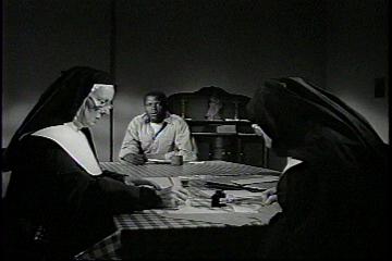

    Does it need colour burst or can it do black and white videos?
    My capture from my A/V Link of Lilies of the Field (1963), United Artists
    Also, remember to keep your capture hard drive defragged, and close all unused applications.
