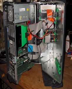

  10. Member hech54's Avatar
    Jul 2001
    Yank in Europe
    My Dell opens up like a pair of scissors(for lack of a better description). AWESOME design. VERY easy to change almost anything in this computer.
