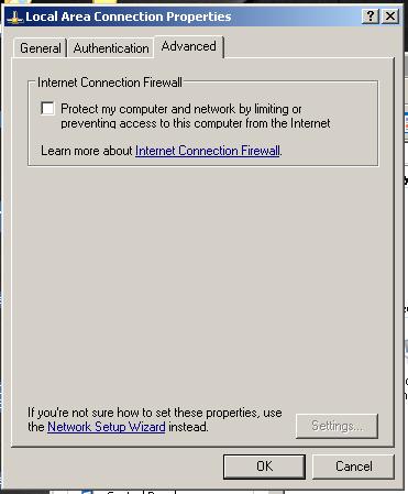

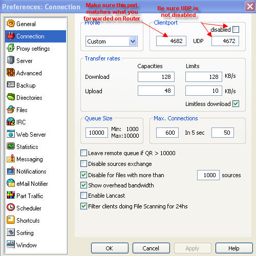

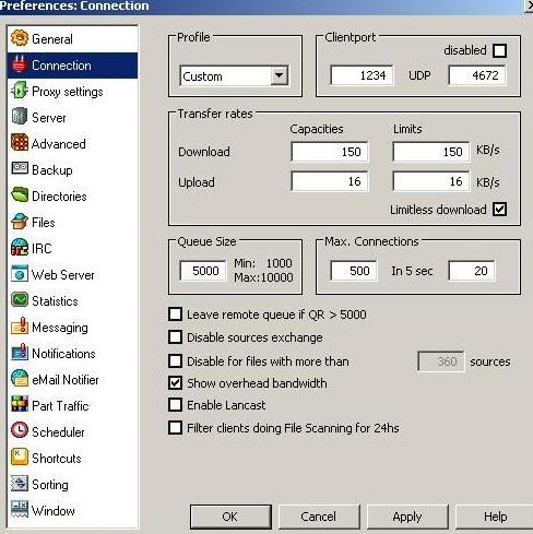

    O.K., did you make sure you changed the client port settings in the config screen of eMule to match what your router is set to forward?
    i.e. you changed to port 1035 - so your router should be set to forward 1035 to your PC's IP address (make sure that is the correct IP address to your PC, and that you're not forwarding to the wrong IP) and then on the Preferences/Connections window on eMule change the TCP port also to 1035. Be sure to remove the old setting on the router and enter the new one in it's place. The UDP you can probably leave alone, that wouldn't cause you to have a low ID.
    Make sure if you're running XP that you turn off the ICF - I made a mistake when I reformatted/reinstalled XP and left the ICF on (it's on by default) and when I tried to get eMule to get a high ID, it wouldn't. Took me a while to figure out that the ICF was on. It was blocking the eMule traffic. It's not really needed anyway, once you have the router going and configured properly.
    Here's what my eMule is set to on the Settings window.
    I'm sure your problem is just a matter of a setting somewhere being incorrect, because you mentioned that it worked fine before you put in the router. Your cumulative UL/DL looks pretty good, so you must have been doing fine before. Don't forget too, that it takes a few hours for your DL speed to get up to par, when eMule is first started it will start uploading at full speed right away, but it takes time for the DL speeds to pick up (but no more than a few hours, in any case). Also if your files have a lot of souces, it will DL much faster than files with few sources. I have over 100 DL's in progress at any given time, so something is constantly downloading. When I first started using eMule, I was only downloading 15 - 20 files at a time and the speeds seemed really slow. Now it reaches 100 KB/s often and as you can see, averages 40.

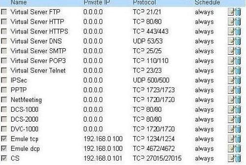

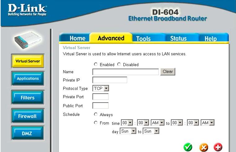

    I don't know what's wrong. This how I set up my router. I had to split up the page in 2 cause 50 k is max.

    I found help on http://support.dlink.com/faq/view.asp?prod_id=1320&question=open+ports
    which is official site for my router and they tell you how to open ports specifically for emule. It says to open it from 4661-4665. And it says to limit the number of connection but I don't know what connections and how?

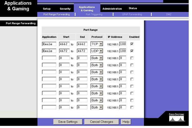

  14. from your latest screenshots, you do not have the right ports. You have 1234 (TCP) and 4672 (TCP). The webpage says 4662 (TCP) an 4672 (UDP)
    BTW, how did you go from a linksys to a D-link router in your screenshots?
    I think I saw something about opening up a range of ports such as your example above, but now I don't remember the reason for it. I have only the one TCP port open (4682) and the UDP on 4672. If it works fine, then why would more ports have to be opened? I'll have to look into this more and see if I can find the page that talked about opening a port range. Until recently, I got a high ID with every server I connected to, now most of them get a high ID but some don't from time to time. As I mentioned .S.E.D.G. always works for me, but I'm starting to wonder if something changed with the servers out there that's causing Low ID sometimes if you don't have more than the one port opened. Or could it be a problem with your ISP, that they are blocking some ports periodically to try and prevent you from downloading?

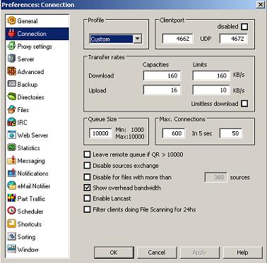

    I also noticed that it looks like you have the wrong protocol selected for your 4672 UDP port - in your last example it shows you're using it for TCP. You might want to change that, though I don't think that is the cause of your problems.
    You can limit the number of connections on the Preferences/Connection screen like my example above: note that I have it set for 600, with limit of 50 in 5 sec. and this hasn't been a problem for me. Since you mentioned that they recommend limiting the number of connections, what do they suggest you limit it to?

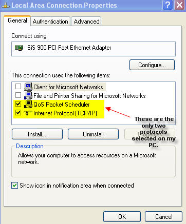

    Here is the LAN settings on my PC, check and make sure yours match what port is being forwarded on your router (192.168.0.100 in your case, 192.168.0.2 in my case). This is very important, if you were to forward to the wrong IP it's the same as no forwarding at all.
    SJM, I think it doesn't have to be 4662 for eMule to work properly, as I mentioned earlier, I'm using 4682 now with no problems at all. As long as the port he forwards is the same as the one eMule is set to use for TCP, it should work fine, afaik.

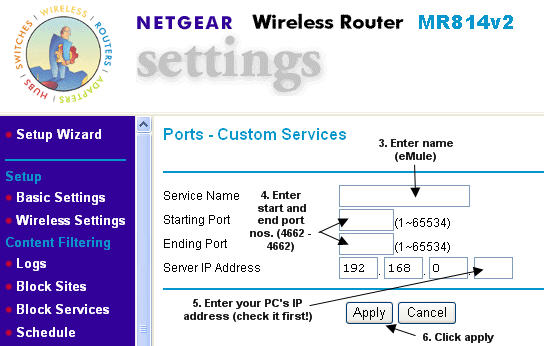

  22. Yes, I Know Roundabout's Avatar
    Jul 2003
    ...in and around the lake

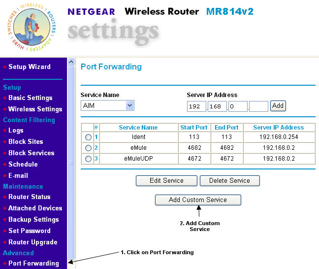

    O.K., here's what mine looks like. You can use 4662 for TCP if you want. Just make sure your PC IP addy is the correct one before you enter. Check it beforehand.
    Repeat the process to set up the UDP port 4672.
    After finishing, just logout and close the window to save.
    Let me know what happens.

    I set it up and Emule has been running for 2h 20mins and no low ids or messages of any kind. The speed is currently 3.1. I will wait over night and see how it goes.

    I'm glad it is at least working and you're getting a High ID. That's some progress at least! I don't know which light you're referring to, if you mean the one just to the right of the green power light, then no, mine isn't orange. It flashes constantly with the activity, but it's green, not orange. Also the Number 1 light blinks with the activity too, at the same rate as the internet light. But nothing is orange. Could it be they changed the color of the LED? I think all the lamps on mine are green, I haven't seen any other color. I don't have the owner's manual in front of me (and don't know where it is right now) - is there anything in there about the light being orange or green?
    Yes, it's good that you changed the SSID and turned off everything if you aren't using the wireless right now - mine is all off too, because I don't have a wireless card for my laptop at the moment and it sits on the desk 98% of the time anyway. That was the first thing I did too, turn off the broadcast totally. The "antenna" light between the internet light and the number 1 light should be off completely, if you have disabled it properly. Beyond that there isn't much else to do.
    The only other thing I did was to forward port 113-ident to a non-existent IP address due to possible problems with just doing a "stealth" on this port. Read this page and you may want to do the same thing I did (note above example in the picture of my forwarded ports). This webpage has more info about it:
    http://www.grc.com/port_113.htm

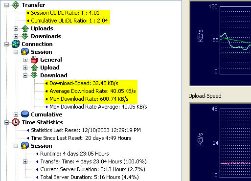

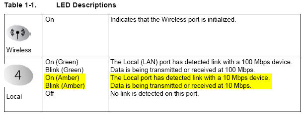

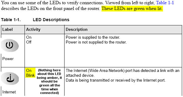

    I called netgear a couple of hours ago about the orange connection light. The representative didn't speak English very well so I couldn't fully understand what the light means. He said something about me not getting all the speed from the cable as I should be. I will call back tomorrow and speak to someone else. I never heard anything about 113 port before. I will check it out later on tonight.
    I run Emule Plus v1i and also leave the computer running at nights too, but I don't get as much from it as you. What bandwidth does your isp claim you suppose to be getting. I have Road runner and it is 1500 down and I think 500 up. Is there a difference on what version of Emule Plus you running, because I read a few threads where they say that some of the Emule versions are not very good so you should stick to the one that works good for you.
    It's good to know about updating, I heard something about credits but I still don't know what it is.

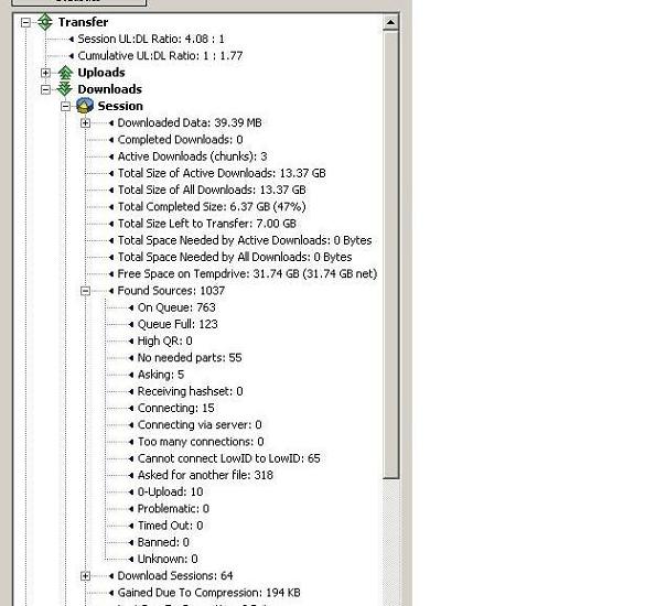

    Rights in Emule my speed is 35. I had a slow speed for about 4 or 5 hours but now it seems it went up. I have 12 gigs downloading.
    Transfer
    Download
    Download-Speed: 35.02 KB/s
    Average Download Rate: 21.07 KB/s
    Max Download Rate: 53.72 KB/s
    Max Download Rate Average: 21.07 KB/s
    It looks like the router works perfectly. Thanks for your help again.

    I got this from the owner's manual, which will explain why yours is showing an amber light - I think if this is correct, the LED for the port your PC is on is amber, not the internet light. See below:
    This is probably what's happening with yours:
    The problem appears to be your firewire card/driver, not the router. It has detected that the fastest you can connect is 10 Mbps instead of 100 Mbps. Do you have a PCI firewire card, or is included on your MB? In any case, this won't affect your download speed, as you mentioned, your max d/l speed is 1500 kbps (~187.5 KBps), and this is running at 10 Mbps. It would only affect the transfer speed between your PC and any other PC in your network (I take it you are only running one PC from this router, so it wouldn't matter). If you don't have more than one PC on your LAN, this will work the same for your eMule connection. If you want, you can try to find out more info about your Mobo or F/W card and see if there's any updated driver you can use.
    The connection speed here is supposed to be 3000 Kbps, but that's probably rarely attained. The biggest limiting factor is the guy on the other end of your connection, whoever you are downloading from. Most people limit the upload bandwidth to 10 - 12 KBps for the same reason I mentioned earlier. Going beyond that won't increase your d/l speed and it will increase disc activity and use more bandwidth (I'd rather not go too crazy with the uploads, more bandwidth means more attention from your ISP, they may start bitching when they see you using 10X the bandwidth of the "average" user).

    I am sorry I haven't answered to your posts but this week has been crazy for me. I don't have time to check email. I just wanted to tell you that the router works great.
    Average Download Rate: 64.72 KB/s
    Max Download Rate: 307.51 KB/s
    Max Download Rate Average: 114.54 KB/ss
    I have crazy speeds like never before.
    I do have a couple of issues I will post it tomorrow, got to finish homework now.
    Slimmx

    I set up a friend of mine last night with eMule, and luckily he also happened to have purchased the Netgear router like you and I have. Worked like a charm the first time, High ID and all. He was shocked at the amount of stuff available at ed2k-it.com - I told him there were many such sites (like Sharereactor), so he's probably busy all day today downloading everything in sight. I don't use those sites, because I'm only after Russian T.V. shows and such, for my wife. I don't care about other stuff, really.
    The Netgear worked perfectly and the port 1 light was green like mine, so I guess something is going on with yours. Any luck yet?

    I took a picture of my router so you can see which light is blinking yellow, it is not the one you think it is.
    I didn't get a chance to call netgear yet. I will probably do it later tonight.
    I also did the complete tests for open ports and configured port 113. I configured 113 same way as you, so now all my ports are stealth. It's a very good site. I was always very catious about security because I buy a lot of stuff online. With the firewall on the router do you think I need to run a firewall such as norton or zonealarm on my pc.
    By the way, the router works GREAT. I have not had a problem with it.

    This is how I set it up Emule
