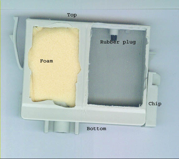

Be afraid, be VERY afraid. Another member of this forum sent me an empty aftermarket cartridge for evaluation. The cartridge appeared well made and at first appearance to be a lot simpler. Upon opening the cartridge up I was pleasantly surprised to find that it was foam on one side and empty chamber on the other side. There was a perforated wall between the two allowing the ink in the open chamber to soak into the sponge filled half. The liquid side has a plug in the top which can be removed and replaced as necessary.Originally Posted by BQuicksilver
In simple terms, you can remove the plug, fill the chamber with ink, let it sit overnight so the sponge can soak in the ink, fill the cartridge again and replace the plug. This will give you a fully filled cartridge restored to the same condition it came from the manufacturer. If you feel along the top you will feel an indentation, cut this out with a razor blade or x-acto knife and the plug will be underneath. A dental pic is a great tool to remove the plug but a safety pin or small jewelers screwdriver will work.
The chip seemed to reset although I was unable to try it in my printer because I had already destroyed it.
So far so good, now for the dark side.
The Epson OEM cartridge has a very sophisticated valve and regulater system. The Epson valve only allows the ink to flow one way, out. So far still good. When the Epson valve is opened, as it is in the printer, ink will not flow unless it is drawn out with suction. The aftermarket cartridge has a valve but no regulater. Once the aftermarket valve is opened the ink will freely flow out of the cartridge. This has the potential to DESTROY your printer and Epson will know how it happened. This could be a costly non warrantied repair.
If you are seeing dropplets or smearing on your pages you may want to reconsider the use of aftermarket cartridges. You may want to also look at the waste collection sponges in your printer. If the sponges are very saturated with ink this could be a sign of the cartridges leaking.
If anyone is having any kind of a problem that might be related to aftermarket cartridge leaks, now would be a good time to speak up.

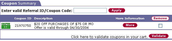

By the way, I bought all 6 cartridegs at Office Depot for $60.77 which includes tax 7%. I used a $20.00 off coupon to get that final price.
Funny thing is that their web site showed as out of stock, but I went to the store and gave the lady the coupon code and she put it in.
coupon code for anyone that cares.
021970750. -

Well, if that's the cheapest OEM Epson carts avaialable for $9.99 color and $13.99 black ($63.96 total all 6) , then why did I pay $60.77 out the door?Originally Posted by BQuicksilver
Yea, it includeds a $20.00 rebate, but I posted the code for you so write it down, walk into OD and buy ur stuff. No waiting for the mail and its cheaper.

Any other good sites for cheap genuine Epson ink? The office depot code above is no longer valid. I tried it today.
The code is still valid. I just used it again. It is valid until 30 April.
Just write it down and walk into ur OD and hand it to them. -
I did, he said it came up as expired. The was a real goon, so maybe I'll give it another shot.
