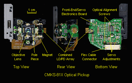

I gave a friend of mine an old Sony Laserdisc player a few years ago, and it stopped reading discs completly. Since I used to fix these, I knew that many times dust gets inside and settles on the lens, preventing it from reading the disc properly. In his case, there was a ton of dust inside, so I wasn't surprised when it didn't read (they never were very good at keeping dust out, lots of gaps between drawer and cabinet of the unit, letting in a lot of dust).
You could try it, use a q-tip and denatured alcohol (preferably not isopropyl "rubbing" alcohol, it leaves residue) and clean the objective lens, it will look similar to that in the photo (see the lens on the left side of the picture). Clean it gently wiping across the lens and turn the q-tip as you wipe to get all the dust off. If you can't find denatured alcohol, it's better just to use a dry q-tip than the other alcohol. You don't clean the laser diode itself, only the objective lens that focuses the beam onto the disc.
If that doesn't cure your problem, try another output on the player, if you have one and see if you are having the same issues (does it have only composite out, or component output too?). If it has the same problem from all outputs, there may be a real problem in the player which will be harder to cure. Good luck.

Yes, and it would probably be a good idea to unplug the unit first
You should be able to see the FOP (pickup assembly) - it will be within where the disc sits (tray area), closer to the inside part of the spindle assembly that holds the disc (because it starts reading from the inside TOC area of the disc first). After cleaning, try to blow out any other dust you can from inside the unit before putting it back together.Ethernet (n): something used to catch the etherbunny -
