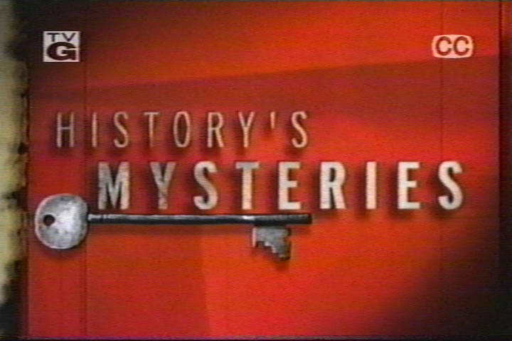

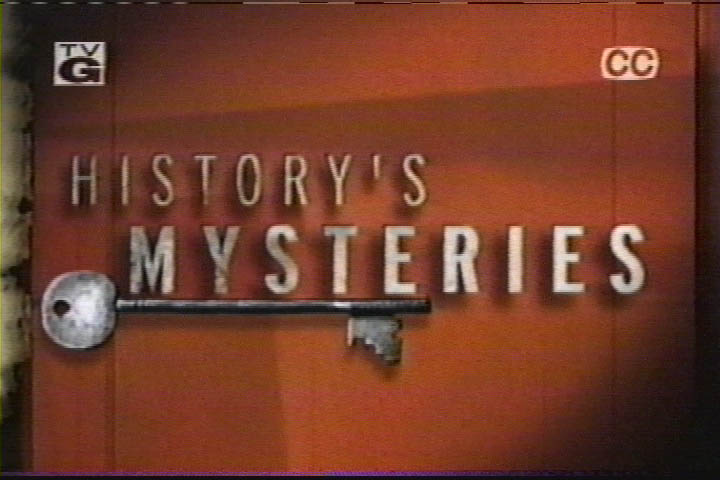

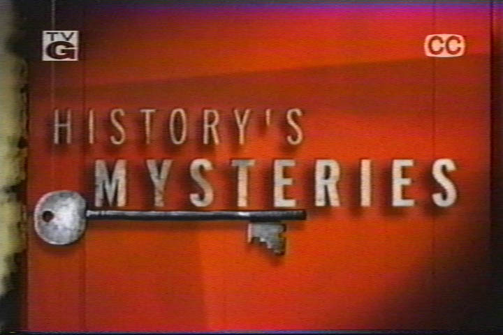

    Anyways here are two pics that I made from VirtualDub. This is the original capture loaded directly into VirtualDub with no filtering of any kind. The AVI is 720x480 and using the PICVideo MJPEG codec on the 19 out of 20 quality setting. This is from a SLP/EP speed tape recorded from cable TV from a channel with generally speaking good reception.
    The first pic shows the blueish/purpleish "haze" and the second pic is actually from a few frames before hand and looks normal. Again the "haze" only shows up some of the time.

    Here is a screen pic of the capture done with the MULTISYSTEM FORMAT converter. Note that the color saturation is lower than in the pics above (which were captured the same way but using the Panny DMR-E20 as a pass-thru device instead).
    Also note the "odd" stuff at the very top. I find that cutting the top by 4 lines and adding black back (so as not to mess up the aspect ratio) is enough to cover that "garbage" so that is what I do for the final MPEG-2 DVD encoding step. I also cut off then replace the bottom with black as well to get rid of the usual VHS garbage noise.
    What do you guys think of the quality of this picture compared to the other two?

    Well I did 3 captures from the same source using the following methods:
    1.) VHS VCR direct to my AverTV Stereo PCI capture card using composite video.
    2.) VHS VCR composite out to an input on the Panasonic DMR-E20 then composite out of the Panasonic DMR-E20 to the AverTV Stereo capture card.
    3.) VHS VCR composite out to my stand alone MULTISYSTEM FORMAT CONVERTER and then S-Video out to the AverTV Stereo capture card.
    The source is a VHS recording in SLP/EP from THE HISTORY CHANNEL cable TV station ... original reception very good. I also tested with a few other tapes including factory pre-records.
    Quality wise:
    1.) Looked like shit from the SLP/EP tape but looks fine if it is a VHS SP tape.
    2.) Looked better especially the SLP/EP speed tape so I'm thinking the TBC does kick in on simple pass-thru but it has that annoying blueish/purplish haze. This happens with all source VHS tapes I tested and I used 2 different VHS VCR model/makes to rule out the VCR being the equipment at fault. Also this "haze" happens not only on pass-thru but also visible on a DVD-R that I made in the DMR-E20 so something is definately wrong with the DMR-E20 that I have. At least that is my conclusion.
    3.) Overall the TBC in the MULTISYSTEM FORMAT CONVERTER kicks ass compared to method 1 with no TBC or even compared to method 2 using the Panny DMR-E20. However there is a bit of a lack of color saturation but I found that this can be compensated for by using the saturation control of my capture software (although the picture above from this method is untouched straight capture with no adjustments). While this TBC puts some "junk" at the top it can be cut out no problem it is in the overscan area anyways. Although the image is very clean (the cleanest of the three) it does worry me that it is not as "sharp". I'm not sure if that is the correct word but look at the first two pics (from method 2) and the second pic (the one posted by itself further down from the first 2) and you will see if you look hard at the pics that there is a difference in "detail". Look hard at the "TV G" logo and the "CC" logo and you should see what I am talking about.
    So in conclusion method 3 looks best but the lack of "detail" is bothersome. So I am wondering if I will get better quality detail using another TBC such as the DataVideo TBC-1000 or the AVT-8710 which is sold on that AV TOOL BOX website.
    You might notice that I used the S-Video output of the MULTISYSTEM FORMAT CONVERTER even though I'm inputting a composite video signal into it. I did this because when I used the composite out that "detail" thing I'm talking about was even worse. Apparently it can send the composite input out through the S-Video and that cleaned up the "detail" issue somewhat but I still see that strange lack of "detail" or "stair-step" or segmented "scan line" look. It's annoying me. And it's the only thing that is really bothering me at this point.
    I don't care about the so-called black level bug of the Panny DMR-E20 since I am definately not using it ever again. Also the unit is known to "correct" the black level bug on output (only the DVD-R still has it when played back on other DVD players) and it appears that the pass-thru method is unaffected by it so again I'm not concerned with that.
    So LordSmurf do you see what I am talking about in that "odd" lack of detail in my second lone pic? Or am I just being really anal
    Again to clearify the first two pics are VirtualDub screen grabs from the captures done through the Panny DMR-E20 whereas the 3rd pic posted later was the one captured through my MULTISYSTEM FORMAT CONVERTER but inputting and outputting NTSC so there is no format conversion but the TBC does apparently "kick in" doing this. Again I could tell that the TBC was kicking in as the capture direct from the VHS VCR to my capture card looked like donkey ass in comparrison.

    I actually think the first two images.. the RED ones.. are more fuzzy than your last one, the DESAT'd one. I'd say let somebody else judge it. Your eyes may be getting crossed from all the tests. Happens to us all.
    Well the 3rd pic (the one with less red or less saturation) looks good and sharp I guess but what I mean is ... look at the difference in the TV G logo and the CC logo. Don't you see how the first two pics are more "smooth" and the 3rd pic is more ... I dunno how to describe it ... but it sure doesn't look smooth.
    You can also see it on the key if you look at the hole on the round part at the end (the part on the far left).
    It's like the 3rd pic looks "jagged" to me. Granted this is from a SLP/EP speed tape but the first pics from the same tape (different capture) don't have the "jaggies" and I see this non-smooth jaggy effect even from good quality VHS SP factory pre-records.
    So this leads me to believe that the TBC built-into my MULTISYSTEM FORMAT CONVERTER is not that great since the TBC in the Panny DMR-E20 does not make the picture look "jagged" nor does the picture look "jagged" when I'm doing a straight capture (VHS straight to capture card with no processing in between).

    The jagged edge is just interlace. Whatever you used for screen caps caught it at a bad moment.

    What you are noticing is that the color circuitry of the Panasonic recorder is not locked up or tracking the color error until several lines after the vertical blanking interval.
    The third image appears to be a single field. The information at the top of the raster is closed caption data which is not visible on an overscanned monitor.

    The first two pics were captured on my computer passing the singal through the DMR-E20 but the third picture was instead passed through a FORMAT CONVERTER that does PAL to NTSC and vice versa etc.
    As I said I'm passing NTSC through the FORMAT CONVERTER so it is not doing any conversion (NTSC in and NTSC out) but like the Panny DMR-E20 the TBC kicks in. As you can see it is a better TBC I think. Overall the picture is cleaner and I don't get that strange 'haze' effect. However the picture does have noticeable distortion in regards to the image being "clean" but now it has "jaggies". My guess is the FORMAT CONVERTER doesn't have the best TBC built-into it.

  23. Member FulciLives's Avatar
    Join Date: May 2003
    Location: Pittsburgh, PA in the USA
    Originally Posted by scottymac
    FulciLives, I think I'm having the same problem as you (Check out my latest topic in this section)
    In addition to the colours fluctuating, I see the purple band every once in a while too.
    Have you hooked the VCR up directly to the TV to see if the problem goes away?
    The problem is not my VCR nor my source (I tried different sources)
    The problem ... in my case ... is definately the DMR-E20
    I only tried the composite inputs but I tried all of them. I have a S-VHS VCR but it broke a while ago. It can pass video and audio though but I didn't try that (working VHS VCR composite out to broken S-VHS VCR then S-Video out to S-Video in on the DMR-E50).
    I read your other thread which seems to indicate maybe this is a problem ONLY with the composite inputs.
    Hmmm ...
    Maybe I'll try passing something through the S-VHS VCR so as to have it converted to S-Video and use the S-Video input on the DMR-E20
    I'll let you know how it goes ...
    - John "FulciLives" Coleman
  24. Member FulciLives's Avatar
    Join Date: May 2003
    Well no luck
    I connected my working VHS VCR to the S-VHS VCR using the composite out and in then went from the S-VIDEO out of the S-VHS VCR to the S-VIDEO in of the Panny DMR-E20
    The Panny DMR-E20 was then connected to my computers capture card with composite video.
    Still had the blueish/purpleish "haze" at the top of the screen.
    It's the unit plain and simple. It might not be as noticeable on a standard TV because of overscan. But it's there ... no doubt.
