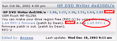

1.65 HP firmware with the latest RFlash8 should work.
http://forum.rpc1.org/dl_firmware.php?download_id=309
Is the flash utility that is downloaded in the 1.65 RPC-1 file the Rflash8 utility or do I need to download it seperately?
Click on the link, download 1.65 RPC-1, extract the files,
run RFlash, follow the instructions. -

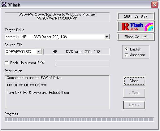

However I am still unable to flash my firmware of my HP DVD Writer 200j.
I read several topics here, used the newest RFlash program and tried to flash with the firmwares provided in one of the topics.
I wanted to flash it with HP's firmware v1.72 but it actually says it wont flash cause no RecordNow software (before I used RFlash). I installed the software and tried again - and it said it cant flash because it cannot verificate the result (whatever this would mean -.-).
Then I came here and found the instructions how to flash it with RFlash (I dont want to have a RICOH DVD burner.. but if there were no other way - I wouldnt mind). So I took the newest version of RFlash and saved my own firmware and tried to flash it with the original or RPC-1 version of HP's DVD200i firmware (v1.72).
Strange thing is that it says: "completeded *OK*OK*OK*" after like... 10 seconds from the point I hit the "start" button. After restarting system my firmware version was still 1.36. So I tried to flash my "backup" back onto it just to see if it can flash on the device at all. It took him like 1 minute and he flashed it successfully (e.g. he completed each one of the steps (erasing, writing etc)).
Now I dont know what to do... it wont let me flash it with a new firmware version (though I can flash the old one)... cause after transfering the data (when doing the second step) the progressbar goes to like 5 points.. and then jumps to the end and it says: completed...

I made a backup of my own firmware (since its the only one working - no other seems to flash itself), downloaded a patched Ricoh 1.72 firmware, had those two folders opened, started the program (which was in the folder with my backup) and when the firmware was chosen I hit "next" and then replaced the backup with the ricoh 1.72 firmware. It said "transferring data" and then jumped to the next step. There it filled the progressbar with just 1/6 of the bar and jumped to the full one saying that it was successful in patching it (which it actually wasnt).
My problem is that I cant even flash it with HP's own firmware updater-program (not even after installing RecordNow). But - to confirm that I can patch the drive - I saved the firmware it had and patched it with it using RFlash (it went through all the steps). So I am actually able to flash (so I think no DMA issue or whatever) but no firmware except my own worked yet.
Does anybody know what to do? Btw if you need any information about my system or whatever - just I ask.
Thanks in advance -
well just to let you know - I did it.
I had to install ASPI, restart my PC, restart it in safe-mode, run the patcher and - thats it.
the burner now writes onto 8x dvd+r and on 4x dvd+rw (not with 8x and 4x speed - but with its usual speed). thanks to you all who tried to help me
