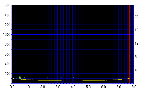

update -
Last night I shifted around my hard drives and dvd drive.
So, now my hard drives at primary slave and secondary master are doing DMA and the two cd/dvd drives are doing PIO.
I ran the cd-dvd speed tests and here are the results -
Nero CD Speed Test results
General Information
Operating System Windows 2000
Drive GENERIC DVD RW 4XMax
Firmware Version 2.15
Serial Number
Disc DVD-Video
Capacity 7.82 GB
Transfer Rate
Start 1.03x
End 1.69x
Average 1.08x
Type P-CAV
Seek Times
Random 112 ms
1/3 120 ms
Full 204 ms
CPU Usage
1X 100 %
2X 100 %
4X 100 %
8X 100 %
Interface
Burst Rate 428 KB/sec
Spin Up/Down Times
Spin Up Time 0.91 sec
Spin Down Time 3.97 sec
Load/Eject Times
Load Time 0.92 sec
Eject Time 1.51 sec
Recognition Time 9.84 sec
Log
Time Elapsed Action
[00:43:10] Starting Transfer Rate Test
[02:16:12] 93:02 Speed:1-2 X P-CAV (1.08 X average)
[02:16:12] Starting Seek Times Test
[02:16:24] Random Seek: 112 ms
[02:16:36] 1/3 Seek: 120 ms
[02:16:56] 0:44 Full Seek: 204 ms
[02:16:56] Starting CPU Usage Test
[02:17:14] CPU usage at 1X: 100 %
[02:17:44] CPU usage at 2X: 100 %
[02:18:41] CPU usage at 4X: 100 %
[02:20:35] 3:39 CPU usage at 8X: 100 %
[02:20:35] Starting Burst Rate Test
[02:21:10] 0:35 Interface burst rate: 0 MB/sec (428 KB/sec)
[02:21:10] Starting Spin-Up/Down Test
[02:21:15] Spin-up time: 0.91 seconds
[02:21:29] 0:19 Spin-down time: 3.97 seconds
[02:21:29] Starting Load/Eject Test
[02:21:31] Eject time: 1.51 seconds
[02:21:31] Load time: 0.92 seconds
[02:21:41] 0:12 Recognition time: 9.84 seconds -
